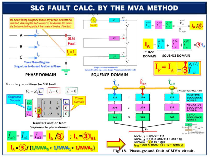

Studying the MVA method for its simplicity. Understand its limitations, but for quick calc to determine min AIC of equipment seems like a good approach.
I can follow and comprehend the method for 3 phase faults. But I am having some difficulty with phase to phase, and phase to ground.
Phase to ground fault:
MVAsc=3/(1/MVA1 + 1/MVA2 + 1/MVA0)
I understand where positive, negative, zero MVA is derived. But, I don't understand why it is multipled by 3. Is it looking at each of the 3 phases going to ground at the same time, so its 3 cables in parallel? Or is it just one phase to ground? If latter, is it normal to have higher phase to ground Isc than three phase Isc?
If the ground fault is on a wye system, say 480/277, and I'm looking for one phase to ground, after arriving to the MVA do I use Vll (480) or Vln(277) to calc Isc?

The Moon paper is my primary reference. But its a bit vague on my questions. For instance, phase to ground. If you have a wye system, do you use the phase to phase voltage, or the phase to ground voltage? Thanks for explaining the 3 multiplier, the Moon paper didn't quite detail that it was all three phases to ground simultaneously. My first assumption there would be a single phase to ground fault.
For SLG fault, the total fault current is the sum of each individual sequence current, that happen to be all equal for SLG. The MVA method like the ohmic or the pu method, calculate initially the sequence impedance current. The total phase SLG fault current is 3 times any of the equals sequence currents. For additional details, see below:

Use the line-to-line voltage (VLL). Notice that to obtain the fault current, the resultant equivalent MVAsc is also divided by the VLL.
