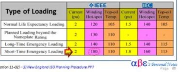

How it can be explained that transformers built per IEEE can be overloaded up to 200% and the one built per IEC only 150% as indicated in the table below. Considering this data along, we can infer that IEEE is built somehow stronger than the IEC and for the same price y will be incline to recommend that for application with continuos ambient temperature above 30 C. If you believe that IEC transformers are better under the above scenario, fill free to let us know your thoughts.

@cuky: "How it can be explained that transformers built per IEEE can be overloaded up to 200% and the one built per IEC only 150% ..."
Answer : Because the majority of the manufacturers build their equipment for a specific user base, and know how they tend to operate. This is not limited to transformers by the way - it applies to pretty much all forms of electrical and mechanical equipment. It is not uncommon for North American manufacturers to supply "heavy duty" designs for industrial applications, whereas European manufacturers tend to provide "light duty" equipment. This not only shows up in long term reliability and lifespan, but in allowable transient loading conditions.
Just one example: a North American manufacturer will put a safety factor of 4 on top of a "peak torque" rating of 10 per unit when designing a shaft for a reversing application. The European manufacturer will supply a safety factor of 2 on a peak torque of 4 per unit. Why? Because the European application is (typically) for cold rolling; the North American version is (typically) for hot rolling. Hot rolling is harder on the equipment, so it sees higher frequency of occurrence and higher peak values for transient overloads.
