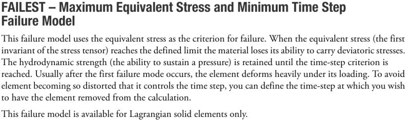

The stress output being referred is "Equivalent Stress". Up on further reading, it seems that Dytran is referring the First invariant of Stress as Equivalent Stress. What is the physical significance of this stress and why is this being referred to? I mean in static linear, I know the significance of Von Mises..hoping to get some similar understanding of the significance of 1st invariant of stress.

This is taken directly from the Dytran Theory Manual about using First Invariant of Stress. Please let me know if I'm interpreting the text incorrectly.

I think their parenthetical comment is an error. I'm pretty sure equivalent stress is von Mises stress here, which is the second invariant of the deviatoric stress tensor.
To me, this looks like a typo in the manual—everything makes sense if you change "first" to "second". If you search the manual for invariant, it seems that they are using the usual definitions (with the first invariant being the trace), e.g.,
Like FAILEST, FAILMES says it uses the first invariant:
Maybe it's a typo but if Dytran really accounts for failure using mean stress, that's fascinating and I'd like to know more.
