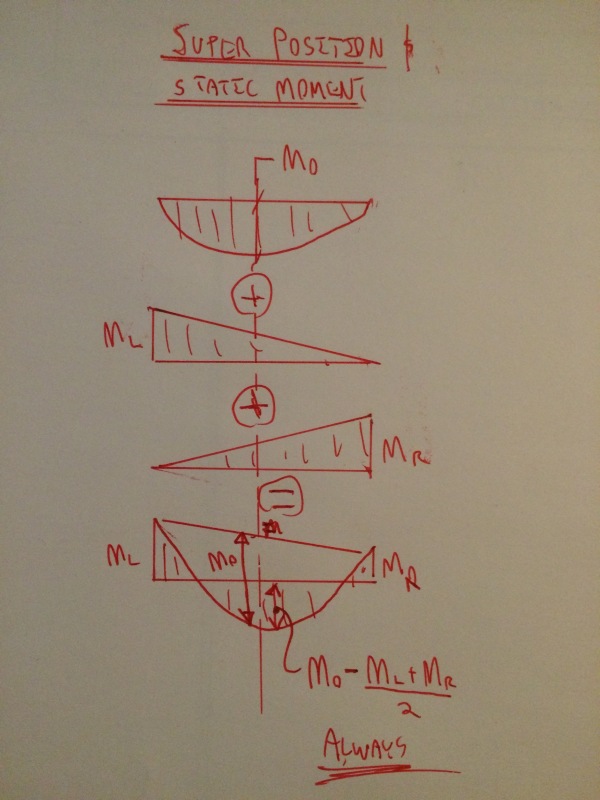

STATIC MOMENT CONCEPT
op said:
But I'm still googling about static moments so hope Kootk can shed more light on it as IDS also requested.
Yeah, my bad. Google doesn't seem to turn up squat and it's all buried in stuff pertaining to moment of inertial etc. I must be using non-conventional terminology or something. I find it unthinkable that such a fundamental concept could be getting so little web air play. I'll just go ahead and outline the method myself. I've included some sketches below as well.
In a very general sense, we can do this as designers:
1) Pretend that a continuous member is simply supported and calculate the moments accordingly.
2) Add any value of end moment to either end of the beam and, in doing so, reduce mid-span values.
3) Super impose the two triangular moment diagrams from #2 end moments with the #1 moments and reinforce for that.
Naturally, this process is limited by the stuff that I described above: presence of adjacent continuous framing and practical/code limits on redistribution based on ductility. As a simplification of the method described above, the classic static moment method goes like this:
1) Assume simple support and calculate the moment diagram and mid-span moment Mo (the static moment).
2) Add in negative end moments as desired and reduce the mid-span moments accordingly.
3) To ensure satisfaction of equilibrium, ensure that (M_left + M_right)/2 + M_midspan = Mo. This can be done graphically by constructing the final moment diagram, connecting the end moments with a straight line, and ensuring that the vertical distance from the mid-span moment value to the line is still equal to the static moment (Mo).
I think that this is an important concept for you because your intuition seems to be telling you that moment can not just be assigned randomly. There needs to be some kind of "conservation of moment" like there is "conservation of energy" in thermodynamic systems. And you're right. The static moment (Mo) is the thing that must be maintained no matter what. It's your flexural design North Star so to speak. Many concrete codes still include a "Direct Design Method" for hand calculation. It usually starts with working out the static moment and then redistributing that moment along the span and, in the case of two way slabs, perpendicularly to the span. This ensures the satisfaction of equilibrium.
The takeaway here is to recognize that the normal process of design is to decide upon the moment field to be used and then to supply reinforcement accordingly. It is rarely the case that we select reinforcement and then attempt to work out a suitable moment distribution to suit that reinforcement. The main exception, as I mentioned previously, is when we're trying to shed some moment at a location where rebar congestion has become a problem. And even then, the process usually goes:

The above is the layout. My friend told me there are many midspan bars in B7 (the horizontal beam at middle) because it has secondary beam crossing it (the vertical beams). But then in the support, he has only 4 negative moments bars (as I shown before) with the 2 in midheight and I'm afraid it may crack so I told the client months ago to reject the plan and find another structural engineer. So don't worry.. the plan was not the one constructed. I told the new structural engineer to put more bars at the support.. or over design it. So there is no problem.

I think what KootK means by "static moment" is really simple span moment. Beams B-7 and B-8 are loaded with a concentrated load P at midspan and a uniform load W representing self weight. The simple span moment is PL/4 + WL/8. A moment distribution would provide the magnitude of the negative moments at supports A, B and C from which the midspan moments could be calculated. The fixed end moments are PL/8 + WL/12.
In doing a moment distribution, it is customary to consider the possibility of unbalanced live loads. It is not realistic to assume live load is evenly distributed over both spans simultaneously. To simplify hand calculations, some engineers use a technique called "two cycle moment distribution" which takes into account any imbalance they wish to consider.

Adding bars at midspan does not make the beam straighter, thus justifying fewer bars at the supports. The beam will feel moments in accordance with elastic theory until the beam cracks. If the beam cracks at the supports because the reinforcement is inadequate, then an excess of steel in midspan may prevent failure but it is not considered good engineering practice.
Why would an excess steel in midspan prevent failure of the supports when the midspan bottom bars won't reach the support at all? Unless you mean it reaches the support (in your first review project of the continuous beam)? If it won't reach the support, then the support can fail and the beam would just fall down.
If Kootk and you are right. Then my friend is wrong to say that adding more bars at midspan can straighten the beam and requiring fewer bars at support. Thank you for this illumination!
This is an interesting topic. Appears to be more complicated than maybe at first look... but what Kootk drew in his big post is what I was taught in my first day in my reinforced concrete course in the university. That is nostalgic...
