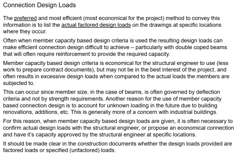

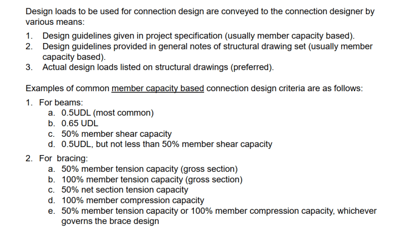

Here's a slide from a connections course I took a few years back. This course was in the context of the Canadian market but should be applicable to NA generally. For those unfamiliar with Canada we only have Limit States Design (same as your LRFD) so ASD vs LRFD is not usually a thing here in this context.
For about 90% of connections I design, Items 1a and 2a are most common. I still get the odd clown that specs full section capacity.

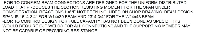

Mend your ways, O funny one... From a project of a couple of days back... it happens often... too often.
and my approach in my shop drawing connection design is as follows (for the same project). I spec the beam spans where there are multiple spans for the same beam. The W14x30 in one instance has a 4' span.
