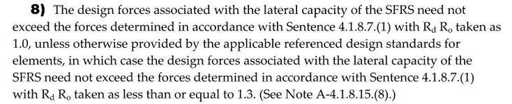

"Beam-to-column connections shall have a moment resistance equal to [probable moment resistance], except that, when the controlling limit state is ductile, the moment resistance need not exceed the effect of the gravity loads combined with the seismic load multiplied by 2.0"
To me this implies that there is a "bail-out" to allow the designer some reprieve from designing to the full capacity of the beam if that value exceeds 2 x seismic load.
For my chosen W12 beam, the moment resistance under the factored seismic load combination is at ~16%. Even under the elastic earthquake load (Rd Ro = 1.0), the moment resistance utilization is still ~50%. Where I am getting kind of jammed up is that this simple structure really has very little load on it, but the wording of the clauses implies that the connection design still needs to be designed for the maximum possible beam moment...even if this is substantially greater than the loads under the elastic earthquake load. I'm wondering if there is a general "bail-out" clause somewhere that I'm missing. I see that Clause 27.1.2.2 mentions that the force "need not exceed those determined with RdRo = 1.0". Reading this clause now (...yes it's 1:15AM), it does mention "...and connections..." and I wonder if this is the correct interpretation ===> run the factored seismic load case with Rd Ro = 1.0, IE = 1.5 to check connection strength, run the elastic earthquake load case (Rd Ro = 1.0, IE = 1.0) to check drift of the structure ... repeat for the 5% in 50 year earthquake because it's post-disaster...
