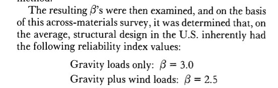

They are there to provide a reasonably low (or "acceptably low) probability of failure, and to accommodate material variations and tolerances. Normal variations in materials, tolerances, etc. NOWHERE in there is an engineer's mistake (or for that matter, a "junk" material, or wildly deficient construction, half the required rebar, half the required concrete strength) factored into this.
Find the literature if you think this is factual. I am not aware of any. Apologies if I misconstrue your comment.

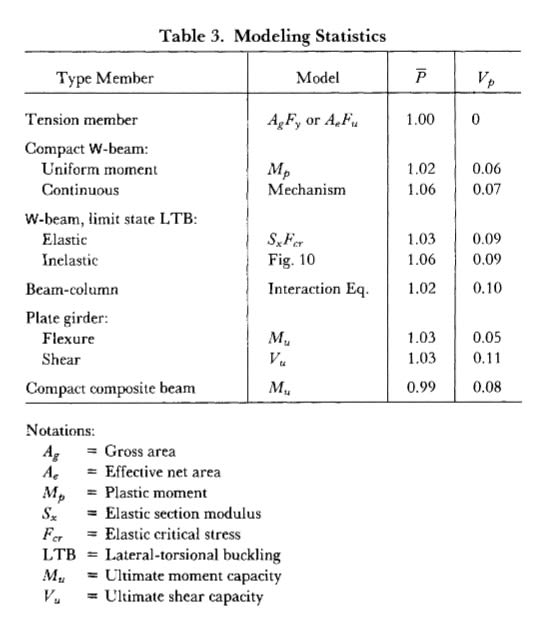

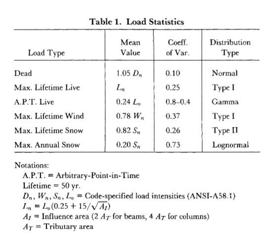

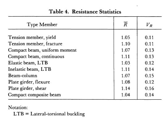

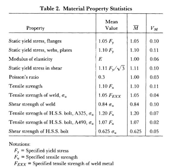

The betas (reliability indexes) [indicies?] for beams are all based on targets of 2.0, 3.0 or thereabouts (this is a wide range in probability of failure as I'm working off recall here and don't want this conversation to devolve into irrelevant minutia). (That's maybe harshly worded more than I mean it to be).
Source: Galambos, 1981.
This is a probability of failure of 1 in 1,000, 1 in 10,000 or less for a component, (to be clear, speaking off the cuff, here I remember seeing these once and don't recall where). Connections, as I recall are "safer" meaning they are higher reliability indexes as we want to prevent them in a probability standpoint because "failure" in a connection can be substantial whereas some beam "failures" involve slight plastification of the section, slightly excessive deflection, and so forth. AISC commentary is available on this subject.
This isn't what I'm looking for, but it's in the neighborhood.
Reliability Analysis of Simply Supported Steel Beams, Idris and Edache, Australian Journal of Basic and Applied Sciences, 2007.
More to the point.....
Galambos, Load and Resistance Factor Design, TR Higgins lecture, 1981. (cited by 153)
Bartlett, F. Michael; Dexter, Robert J.; Graeser, Mark D.; Jelinek, Jason J.; Schmidt, Bradley J.; Galambos, Theodore V. (2003). "Updating Standard Shape Material Properties Database for Design and Reliability," Engineering Journal, American Institute of Steel Construction, Vol. 40, pp. 2-14.

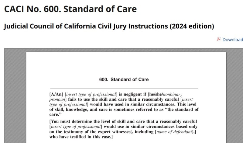

Moving back to the Standard of Care, [ In the U.S. we are basically "witch doctors with slide rules and pocket protectors" (my phrase). We practice an art and/or profession, similar to a Doctor, Lawyer, Accountant, or other Professional. We are trusted (in fact) with protecting the life-safety of the public in performing work that they CANNOT asses is done competently done (unless, I suppose, they want to repeat our schooling and apprenticeship).
Our standard of care is to practice within the parameters of our "local peer group" (if you would). So, if you live (as a Doctor) in an area where EVERY doctor leaves surgical instruments inside the patients body cavity, along with five or six surgical sponges, then you're practicing within the standard of care. (I suggest you not get surgery in this area, however, go to Thailand for surgery).
CACI instructions 600
What is the Standard of Care, Kardon, Forensic Engineering 2018: Forging Forensic Frontiers ( I don't seem to actually have this, hmmm).
Ok, here:
Source: Kardon, Testifying Regarding the “Standard of Care”, ASCE 2009 Forensic Engineering.
I might as well include the various tables from Galambos in the development of LRFD (LRFD has a "rational" safety factor based on probability and statistics, ASD has a non-rational safety factor based on the development of the codes prior to the statistical and probability methods developed and applied in LRFD, the two are not that dramatically different, fortunately, but the point being that ASD had no known probability of failure, even if LRFD did not produce dramatic changes, the work was still necessary and foundational in establishing a baseline "safe" probability of failure.

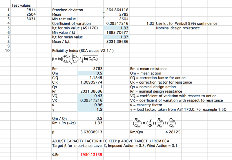

I'm not an expert in material/prototype testing, but I have worked on a few projects where prototypes were tested and the capacity factor determined. In these calculations there is a minimum reliability index that needs to be achieved and in doing so both the material capacity factor and load safety factor directly relate to the reliability index. See attached for an example (this is old and hasn't been checked so it is an example only). The example is for Australia using the NCC.
In this case, a safety factor is chosen (eg. 1.2 or 1.5 etc), then the capacity factor is adjusted until an appropriate reliability index is achieved. If you want you can go in reverse and decide a capacity factor, then calculate the appropriate safety factor. In either case, the safety factor and capacity factor are directly related in order to determine the reliability index of a given material/construction.
