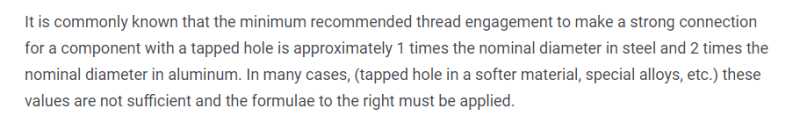

I have a 3/8"-24 dia A307 Grade B fastener going into an HSS 6x6x0.188 column. The client wants to drill and tap the column (doesn't want to use TEKS fasteners which I spec'd). The load is less than 15% of the A307 fastener. Min ISO engagement is 5/16"
Is there a minimum wall thickness that I can use? Is calculating the capacity with a good comfy factor adequate? and ignore the engagement length? I don't have a problem doing this unless there is a real contraindication... and just glue it in place with Loktite Red...
Thanks, Dik
Typical full strength engagement is 3-4 full threads, so 4/24ths of an inch (.170) which is marginal. I'm sure the ISO minimum is for factor of safety. Beyond 3-4 threads there isn't enough elastic deformation to transfer load. First full thread sees almost 50% of the load. You are more likely to see problems from installers giving it the extra oomph they think it needs or being too aggressive with cleaning up the hole with a csink after tapping.
Thanks 3DD... Pretty much what I was thinking that 3/16" nearly gives me 4 threads... which not happy about, but think will work... Rather than overtightening, I was thinking of 'glue'. Load is only a few hundred pounds...

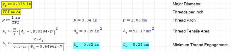

I had no concern about the load... it's just knowing why it works... I'm kinda quirky when it come do doing things... even wrote up an SMath program for it. A little overkill, but can use it for more interesting stuff in future. I write the programs on my own time... For small loads, I like to see a minimum of 4 thread engagements... but just wondered if there was something that I was missing and that there was a 'defined' minimum thickness... I'd have pointed that out to the client... just don't like the connection, I'm happier with TEKS, which I know works... gluing them in with Loctite Red, to boot since I don't want to overtighten and strip the threads and I don't want the connection to loosen... my only concern.

Is there a means of calculating that? I did some quick calcs and with the thickness being less than the minimum thread engagement, I was looking at about 20% of the capacity, and the actual load was a lot less.
