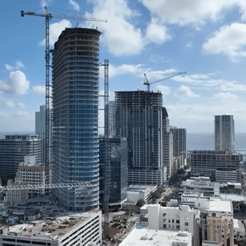

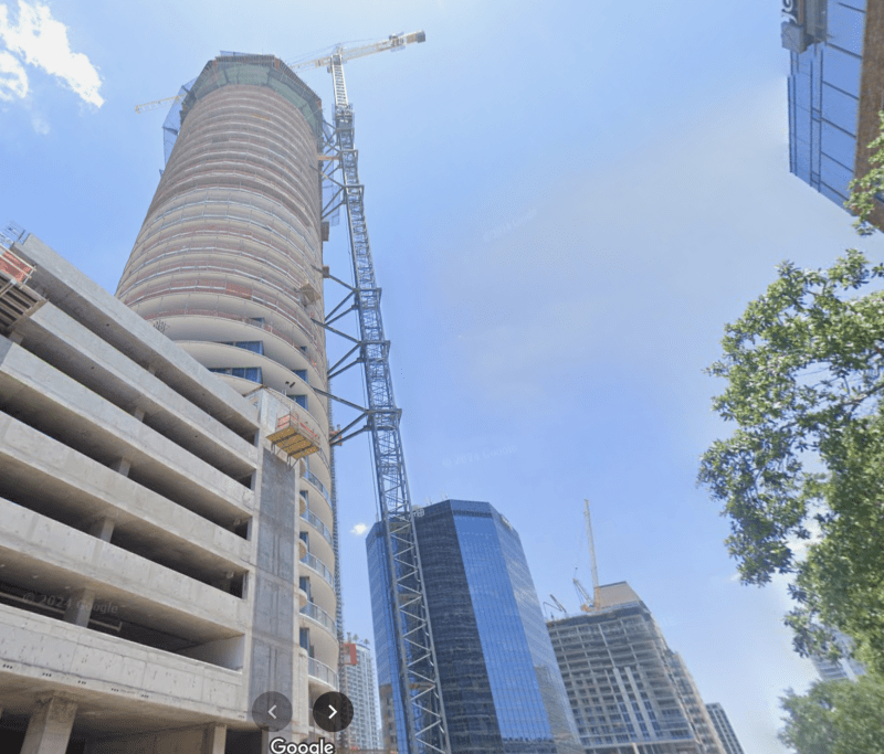

The crane seems to have had significant bracing, if not interesting.
Google Maps (dated May 2024)

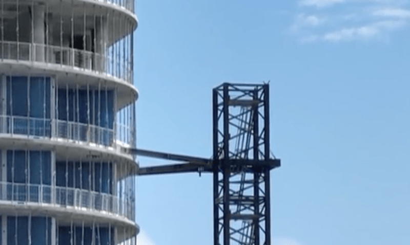

It seems like a clean break at a tower section connection with one or more braces letting go above.

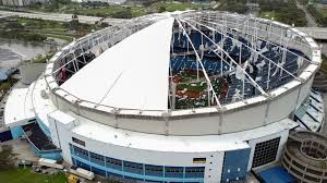

Maybe off-topic, but it is reported the roof of the Tropicana stadium was designed to withstand 115 mph winds, although the NWS reports the highest gust measured in St. Pete was 101 mph:
Downdraft/local variability? Defective Installation? or Engineering Failure?
Since the covering of the rook was canvas I suspect that the statement that it could withstand 115 mph wind was respect to the structural members holding up the roofing material, as it looks like it did pretty well. In fact, when I read that the roof itself was made of canvas I figured that it was sacrificial, that is it was designed to tearaway without taking the roof structure with it. The cost of replacing a canvas roof every couple of years wouldn't be all that much compared to having to replace the structure itself. Besides, in that climate with the heat, rain and hot Sun, that canvas roof had to have been an expendable from the beginning.

Localized winds can be very capricious. As I look closer through the images, it's quite possible that there was no further bracing above the point of failure and the wind just leveraged the boom to take out the connecting hardware.
Apparently it was to be used as an emergency response staging area. It would be nice if the umbrella stayed up.
There is the difficulty of measuring wind speed close to the ground without being swamped by radar return clutter, so what was reported was only the maximum of what was measured and may not be the maximum everywhere.
Wear and tear on the material might have degraded it (see quote below) or the designers didn't run an analysis that coincided with every possible wind direction or some other factor, like having a door open and allowing the stagnation pressure build up inside and combining with the drop from dynamic pressure outside.

One of the most striking moments of Milton came when the roof of Tropicana Field, home of MLB's Tampa Bay Rays, was torn off. The 34-year-old stadium was scheduled to be torn down as the Rays plan to move to a new stadium next door in 2028, but the next three years of the stadium are now in question after the roof's downfall.

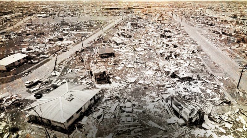

Surely houses should be designed for that very predicable event in a hurricane zone? That seems like an awfully big failure of design codes to me. For cyclone codes down here the code works on the assumption that windside holes will occur.
Cyclone Tracy almost 50 years ago taught us that lesson.
I think one of the news items I saw said that the stadium roof was cable and fiberglass.

The other crane on the same building was still standing, so perhaps it was just local acceleration from the wind passing over the building that exceeded the ability or the free swiveling to weather vane didn't. Looks like a clean break, no large amount of twisted metal dangling. Maybe updraft pried it off?
