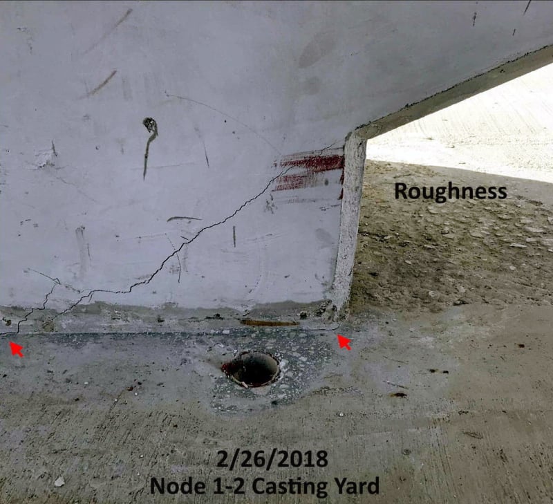

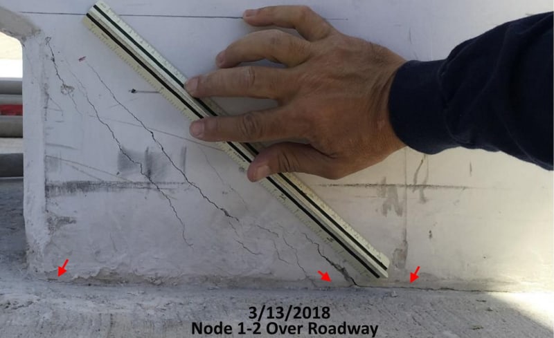

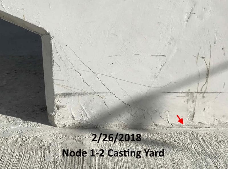

The 1-2 Node makes for an interesting comparison.
Yes, that joint is broken like the one on the other end, and while still on the ground. The deck bottom flange is shortening, and the diagonal wants to resist. No amount of roughness is going to stop that separation. Right there is where the project should have been stopped for further evaluation.

But we are not seeing any truss or frame action when the structure is still on the ground in the casting yard, as shown in the first two photos epoxybot showed above. Those photos clearly show differential movement between the deck and the diagonal, which can only be explained by volume change in the deck.
Much larger structures have been moved far greater distances; some decisions for this move were poor, but moving as a concept is not inherently an insurmountable problem. It's possible that had the original plan been used, the initial ruptures would have happened during the initial lift at the fabrication site causing a halt of movement at that point.

Look at the photos which epoxybot posted. The "initial ruptures" happened even before the lift. That didn't stop them.
Earth,
Then how would you explain the differential movement when it was still in the casting yard? Do you think those cracks were sufficient cause to stop and rethink?

The shores were removed in the casting yard before the cracks showed up.

Do you know that? Do you know how it was supported at the time of cracking?
My opinion is that this was an indeterminate, non-redundant structure, so we disagree.
