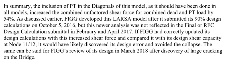

I can confirm the 571 kips is way too low.
The value of 571 Kips for interface shear at 11/12 is less than the vertical end reaction contributing to truss action under unfactored dead load. (Less than the total end reaction minus half the first bay of canopy and half the first bay of deck).
Where did the 571 come from?
From here:
MCM post-collapse NTSB submittal document #628566 said:
...FIGG reported (571 kips) in its 90%, Final and RFC design calculations for the Simply-Supported case.
And to bring the 571 kips into context, from MCM submittal, page 96:

In page 1387 (Section 10) of FIGG's calcs (LUSAS results) and from simple span analysis of (DL+ PT) the number 570.6 kips appears in the Fy resultant. However, in page 1283 (Secion VII) the rebar in the connection 11-12 to deck is calculated by Mr EDL and checked by Mr. MF using a 987 kips force (which is still low). The interesting thing is that in page 1298 (a few pages away) Mr. WDP (checked by Mr. MF) uses a force ("from Eddy") of 1521 kips to evaluate the nodal zone.
So, is it 987 kips or 1521 kips? Is 1521 kips a service load or a factored load? Because 987 kips appears to be a factored load... Looking at Mr. WDP calcs, it seems that the 1521 is a service load comb. So the factored load may (ball park and conservatively) about 1.25x1521 = 1901 kips (vs 987 kips)

It's too bad that the NTSB meeting apparently "barks up the wrong tree" about using the results from the simple span (main span) model rather than the final bridge model.
The problem doesn't seem to have been about using the main span-only model. After all, the bridge failed in a simple span, main span only configuration. So a simple span model is appropriate for that stage. And has been noted, progressing in the bridge construction (post-tensioning aside) would not have substantially increased the shear forces at the failed node. (Correct me if I'm missing something there). Certainly not double. The 570-600k demand being so different from the final bridge model should have raised flags.
It seems to be that the issue isn't which model was used, but that the simple span model seems to have been used incorrectly (to determine the demand forces to be counteracted). Per M&M's explanation, potentially software user errors. Or even if that's not the case, results that seem to not have been back-checked (e.g. by hand calcs).

The model matters because the model FIGG used for their calculations, the simple span, overestimated the dimensions of member 12 and ran the calculations as if the backspan was partially in place. FIGG never properly accounted for the forces in the structure when the main span was supported with no contributions from the backspan. MCM’s analysis of FIGGs work states (page 92-93):
In the first model, Member 12 has the cross-section properties corresponding to the large (full) Pylon, even in the Simply-Supported stage prior to the erection of the Back Span and full Pylon. This indicates the results from the first model for Member 12 may be unreliable for the construction stages prior to integration of the Main Span and the Back Span.
I read this as the simple span model overestimated the dimensions and thus the capacity of member 12, amount other errors.

Vance, I’m trying to find the calculations you asked for in the reports. The dimensions of member 12 are mentioned in MCM’s analysis of the collapse but I am looking for confirmation of this in FHWA report. Starting at page 76, they go into FIGGs use of computer modeling to analyze forces and capacities at the various node during the different stages of construction. But FHWA never addresses the dimensions of member 12 as used for FIGGs various models/calculations. The only place I am finding this information (it may be mentioned elsewhere) is in MCMs analysis. On page 95 of MCMs report, it looks at FIGGS LARSA model:
First, the cross-section assigned to vertical Member 12 is 28 square feet, which is much larger than its actual cross-section of 5.03 square feet at the time of Main Span transport. Given this large difference in cross-section, the load effects reported for Member 12 by this model are not expected to be accurate. Second, the PT load effects reported from this model only include the effects of PT applied in the Deck and the Canopy, not the Truss. PT in diagonal Member 11 (or any other diagonal) was not included, the application of which would have increased the axial and horizontal shear forces in Node 11/12 by hundreds of kips. Third, the model did not include the construction live load of 20 psf specified by FIU’s Design Criteria, which would have again provided even higher design loads.
While the construction plans outline 4 distinct stages of construction, it seems like there was an intermediary step between stage 3 and 4 whereby they poured the pylon for the backspan adjacent to the existing pylon/member 12. This was the pour that the EOR was recommending in the March 15th meeting, because it would help “capture” the 11/12 node and provide more support to 12?

Lomarandil is right. The probable cause seems to have been black box user error (software analyst using "method of slices" at the interface instead of slightly away from the interface) and a failure to check black box output against a ball park, back of the envelope, hand calc.
Regarding the LUSAS software, I know software makers have no liability, and I have zero experience with LUSAS, but this method of slices at an interface seems like a problem.
Regarding Figg's 2,000 or 6,000 or whatever pages of documents. That is a big part of the problem also. No EOR can provide adequate checking or oversight of all of that garbage documentation.
Same goes for the Figg's fragmented design team. You have a self identified stress analyst emphasizing that he is an analyst and not a designer. You have an engineer saying I only designed the substructure, you have an engineer saying I only designed the back span, you have an engineer saying I was the principal engineer for the superstructure but I just used the loads that so and so analyst gave me.
