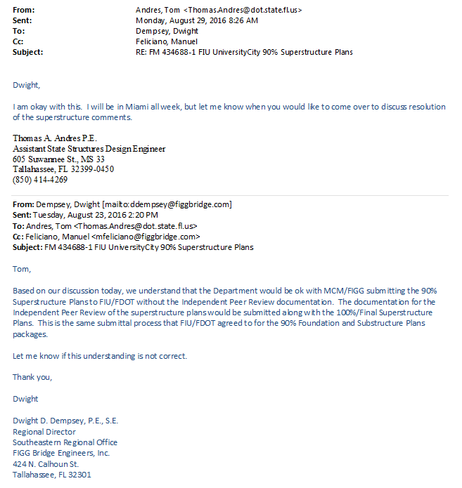

FDOT & FIGG email regarding 100% Plans PEER Review. The NBC Timeline is quite handy.

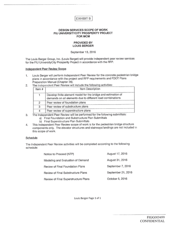

Scope of Work
That looks like a typical communication. Everyone one wants to get their foot in the door for permit approvals so the last thing to get submitted is the independent review documents. You have to be close to finishing the design drawings before the independent review is completed. At least now we know the drawings would have been close to finished for the review.
I didn't see anything there that prevented Berger from examining the whole construction scheme, including the main span standing alone. The scope required them to review the whole bridge, but not before the documents were complete. OSHA may have misinterpreted, or been misinformed, about reviewing construction stages as opposed to design stages. The main thrust of OSHA's report is that the road below should have been closed, and no one now should argue with that.
Peer Review by Berger
From the schedule proposed by Berger we learn they intended to spend 7 weeks on the peer review. That is 35 working days and for a $61,000 fee that is $217 per hour.
The Berger scope includes the following:
3. The Independent Peer Review will be performed for the following submittals:
b) Final superstructure plan Submittals​
An hour spent studying the plans would have revealed to an engineer that the 174 foot span was required to span and support its own weight and construction loads for a period of time, until the back span was complete and cured.
I have no experience in performing FEA analysis - how much time could it have taken to remove the back span and everything except the bare 174 foot section from the model and run the 174 foot section independently with dead load and construction loads?
The ABC idea imposes different conditions than typical in-place construction - (all here understand that). In non ABC construction, the contractor is responsible for everything - falsework, materials, jobsite safety, procedures, public safety (with approval by the agencies) - the contractor "owns" the thing until it is complete and accepted by the Owner and authorities. The design of any portion subject to ABC procedures would be the responsibility of the design firm. FIGG's drawings show the steps for the ABC process in this project.
It appears that everyone thought if the finished structure works it will work at every step in the process.
But were the ABC requirements of this project not addressed clearly on the "Superstructure Plans"?
I think we would find the emails between Berger and FIGG very interesting.

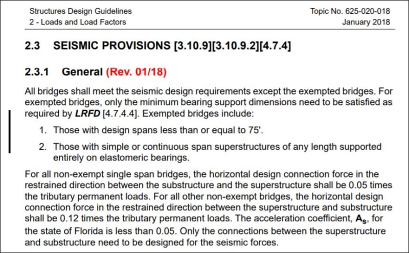

Seismic Connection to PYLON
The completed superstructure is connected to the Pylon but has slip bearings at the south and north ends. The ends have no provision for restraint in the east-west or north-south direction.
FDOT section on Seismic:
The completed structure is a two span bridge and for seismic loads the entire superstructure is tributary to the pylon. As I read that, the connection of the superstructure to the pylon would be 0.12 X (950 tons X 270'/174') = 177 tons or 353 kips. That seems to be adequately resisted if the member 11 and 14 loads are otherwise accounted for.
The superstructure itself is exempt from seismic design. I presume the pylon and substructure would be designed for this horizontal force.
