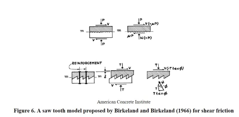

The Mad Spaniard (Structural)9 Aug 19 21:04, good post. My response to item 2:
Saw tooth model 1/4" amplitude roughening
PDF > Link
Birkeland and Birkeland
Dowel action offers near zero resistance at start of slip motion.

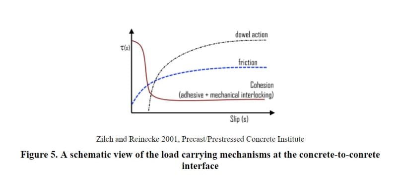

Comments on the general subject of shear friction:
I think FIGG was correct to discard cohesion as contributing. It seems to me all cohesion would be lost due to the slip necessary to mobilize cross-plane reinforcing in tension.
The 1/4" of intentionally roughened surface is commonly achieved by raking the surface before the concrete has set, using something like a heavy asphalt rake. The surface is rough - you would not want to slide into second base on it. But then comes the next pour - with maybe 1/2 inch and 3/4 inch aggregates. The aggregates cannot fit into the 1/4" rake marks, so only the paste and sand can "mate" to the roughened surface. And then there is the slump required, the vibrating of concrete to completely fill all voids, and the fact that the closest access for a tradesman is 16 feet above the joint. What could go wrong?
I have seen rock pockets at the bottom of pours - honeycombing - with little paste to lock the aggregates at the surface of a previous pour.
So with no aggregates in the toothed interlock, when does the concrete matrix simply powder and then lubricate the moving joint? Of course it has already failed if it moves that much.
Regarding the 800 psi upper bound - is that applied to the sum of all components - cohesion AND friction from clamping of reinforcing AND normal force across the joint?
