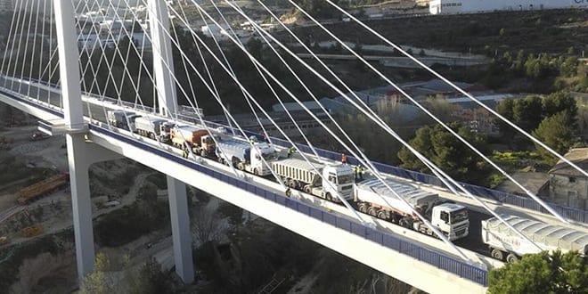

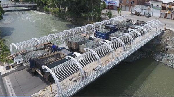

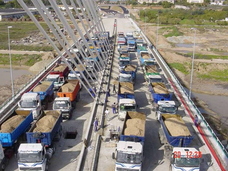

Regarding the Bridge Testing, in Spain , for instance, it is typical to perform a load test on a bridge after construction to everify its behaviour in service. See below some examples.
As you can see, it is done with trucks full of sand. Several arrangements are perform to evaluate the critical load conditions.
In the USA, well... I have not heard of any load test similar to thos that can be sen in the pics.

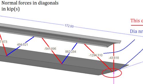

for the moments in the Miami structure, Mr. Kaljas has shown somenumbers.

Mad Spaniard....they must pay those truck drivers a LOT of money to load the bridge and stand their waiting to see if it collapses or not.

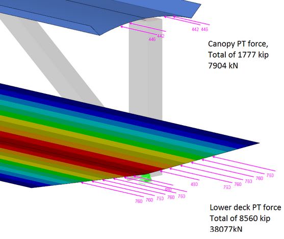

The Mad Spaniard,

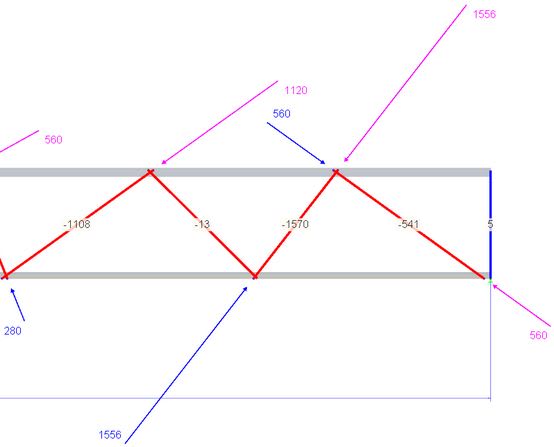

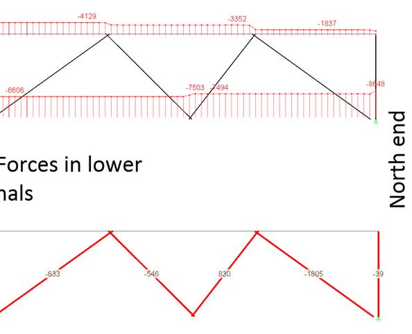

One drawing is missing within the updated work done by Mr Kaljas. There is no drawing showing the loads in ALL members resulting from stressing of the longitudinal PT. Take member 10 for example. If I'm reading his presentation correctly:
Axial-PT = 1570 K
Axial-DL = -862 K
Axial-total = 830 K
However, 1570-862 = 708 K, which is a difference of 122 K. I don't expect Mr Kaljas to redesign this bridge for us, but I was just curious. Thanks.

Mad Spaniard, despite our picking apart this project, I fully agree designer accounted for all the core details we bring up. Conversely, I do feel the standard to criticize the concept (not the engineering) of this bridge is looser. And no computer program as an output that says you can skip empirical testing of a new concept. I believe the biggest contribution of this thread is providing strong evidence this design concept and building technique combined is untested and unproven worldwide. Kansas City and Columbia both occured while I was in college and made a lasting impression on me.
The rubble fracture is consistent with 8,500 PSI. Aggregate snaped. I have seen some analysis that states over reinforcement with re-bar can be just as bad as too little as it removes what little ductility there is. I don't know.
P.S. Sorry about the load test image.. did not mean to go there. I've tried to quit this thread many times, but it's too intriguing. My son is in high school and the events in Texas this morning have left me stunned, so I think I will quit now for a while.
Greetings TheGreenLama
The axial PT value (1570 Kips Compression) that you mention is the result of applying diagonal PT bars to the truss. . It does not include the effects of the longitudinal tendons in the canopy or the deck. The dead load effect (862 kips tension) Plus the effect of the PT bars (1570 kips) plus the effect of the longitudinal tendons in the canopy and the deck ( 122 kips compression) provides the total of 830 kips compression.
So what happens is that even if you prestress the heck out off the deck or the canopy , the relative stiffness between the longitudinal members (deck and canopy) and the diagonals causes the diagonals to get very small axial forces out of it.
Best regards

The Mad Spaniard,
I don't want to belabor the point about what is likely a rough computer model, but what you're saying about the change in axial load (122 k) from the application of the longitudinal PT amounts to a 15% change in loading in member 10. I don't consider that insignificant. Are there moments generated as well within the system from the PT loads? For me that would be a disastrous by-product, due to the minimal shear reinforcement provided in the diagonals.
