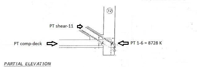

chris snyder, Thanks for the post-tensioning sequence. I knew it had to be spelled out somewhere, but I was just too lazy to find it.
Before you posted it I was just assuming that the deck was poured, then all deck tendons were stressed, prior to working up and casting the diagonals. But now I see this is not the case. And it raises an interesting question: Why? Since everything was supported on falsework I don't see the need to wait until entire superstructure is cast before beginning stressing operations on the deck. Does anyone have any ideas as to why you'd want to wait?
The reason I raise this question is the following:
By waiting to stress deck PT, aren't you unnecessarily introducing into the system a shear force at the base region of member 11? This would be locked in, and subsequently added to the shear loads generated from dead loading when the falsework is removed. Wouldn't it, or am I missing something?
We'd expect to see the same "shear lag" effects that have been thoroughly discussed elsewhere in this thread with respect to the dead load. And the deck is much stiffer than member 11. So most PT force will stay in the deck, but some fraction will move into member 11. It's hard to say if this is a significant load. A computer model would tell the tale of the stress history.

Greetings to all
Regarding the stressing operations:
All stresssing. deck, canopy and diagonals, were made in 1 phase after the main span was cast on temporary supports at the side of the road.
Mr. Toomas Kaljas, whose analysis was posted in a previous thread, has revised his analysis incorporating the PT based on the existing published contract plans. The analysis show that almost all the load goes to the deck or the canopy because their stiffnesses. The diagonals get only a small load. For practical purposes, worthy of not being accounted for compared with dead load.
Good hunting...

Greetings jr87
Given their thickness, the canopy and the deck can not span the 175 feet by themselves. The system acts mostly as a truss for dead load and live load. Now, it can also be considered as a "beam" the same way that you take a concrete beam and the shear is evaluated using "truss" behaviour having a compression flange at the top and a tension flange at the bottom.
Now, at the ends of the span, we may have a little of "beam" behaviour because the north temporary supports are distributed transversally and we do not have a support directly under member 12. For the south, we have two bearings 5 feet away from the centerline. These two details may have some effects on the "truss" behaviour of the bridge. As I have not done a 3-D analysis, I can not say where we are.
For the longitudinal PT in the canopy and the deck, the results from Mr. Kaljas indicate that the diagonals get very little load and that most of the straight tendon compression force is absorbed directly by the canopy and deck.
Typically, the canopy should not have longitudinal PT because it is in compression. However, because the back span is attached to the main span at the end of construction. the structure acts as a "two span continuous beam" and therefore there are tension forces at the canopy near the pylon due to live load. Also, because the back span is let go after being attached to the main span, this causes negative bending near the pylon with the corresponding tension forces in the canopy. This is probably, why the designer placed PT in the canopy. Also, for symplicity, they may have decided to extend the tendons all the way to the ends. At the ends, I doubt that you need so many tendons...
Best regards
Live long and prosper.
