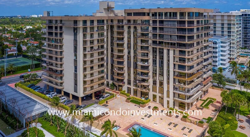

I'm SUPER SUSPICIOUS about that central chase with elevator/stairs/utilities. That wall is the failure plane and those shafts are definitely part of the shear transfer. I must have had at least 20 projects where the transition point between slabs and shafts are a total mess during rebar inspection and require lots of extra work to keep going.

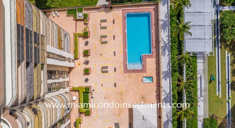

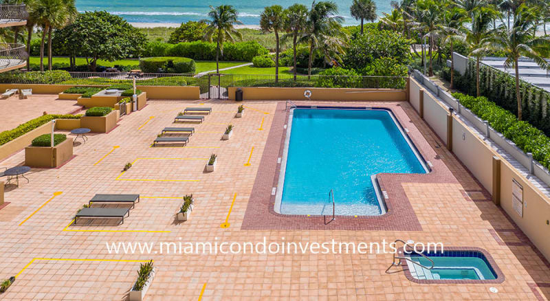

"SURFSIDE, Fla. (AP) — The oceanfront condominium building that collapsed near Miami had “major structural damage” to a concrete structural slab below its pool deck that needed to be extensively repaired, according to a 2018 engineering report on the building.
The report was among a series of documents released by the city of Surfside as rescuers continued to dig Saturday through the rubble of the building in an effort to find any of the 159 people who remain unaccounted for after its collapse."
Anyone able to obtain a copy of this report?
NYT Article indicates that column cracking was epoxy injected, but cracks reformed directly adjacent. That to me is a pretty clear indicated that the root cause of the cracking still existed. If there was embedded and ongoing corrosion of the rebar for the columns that wasnt addressed in 2018, that may be a contributing factor.
I see from the drawings there is a transfer beam as well, I have not looked at the shear reinforcement in that area, but if the reinforcement is corroding in the below grade beam, but if the Vs value drops due to corrosion of the ties, that could be a source of concern as well.

Question for the SEs: i've got a "can you design this building like this under todays codes?" question.... Specifically, can the stair tower in the far wing NOT be designed with just 1 shear wall? Isn't there some limit to how much open floor plan you can have before you connect to a shear wall? (Seems like there should be, just sayin') The video shows the building dropping up against the central shaft first.... then there is a delay and far end of the wing becomes unstable and drops. I wonder if that stair tower had been a full rigid box could it have done the job of halting the progression and saved a third of the lives???
