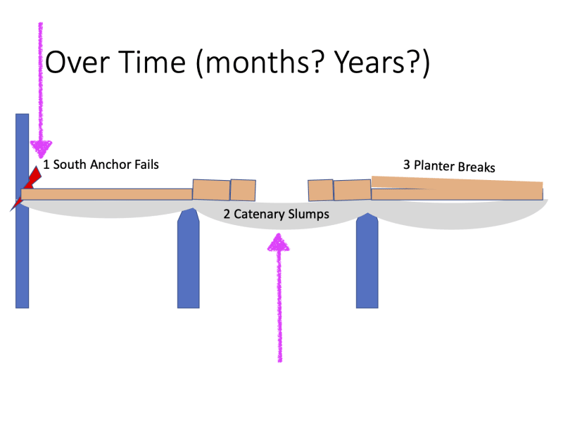

“Catenary Stubs’. Got Love ❤️ It!
SFC, Outstanding Power Pointy! Now to digest

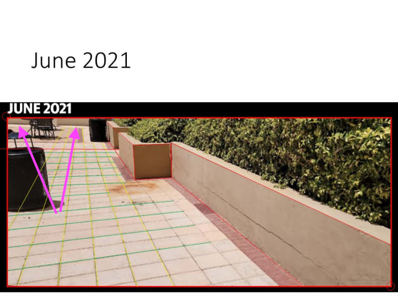

"Over the years" Five Years? I mean, the gravel of the 5 year old "walk" is flowing out where the anchor was? Maybe they trip-hammered the bottom of the CTS perimeter wall, when they trip-hammered the pavement (sidewalk?)? I've had a curb broken when the adjacent pavement was removed.
SF Charlie
Eng-Tips.com Forum Policies

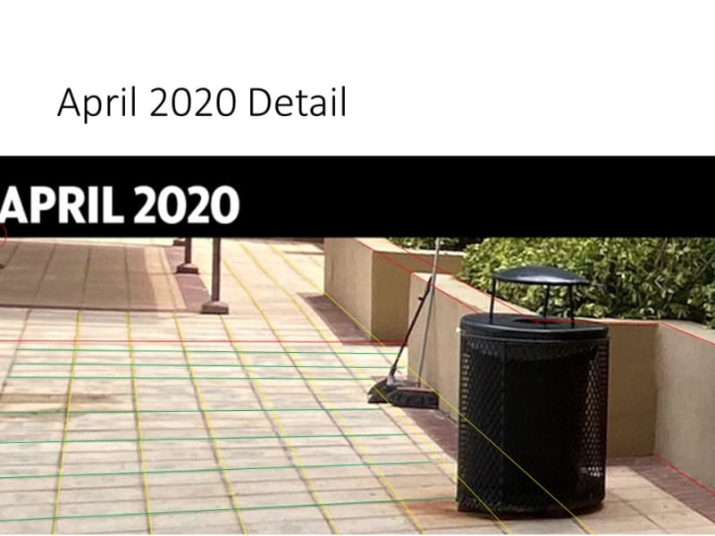

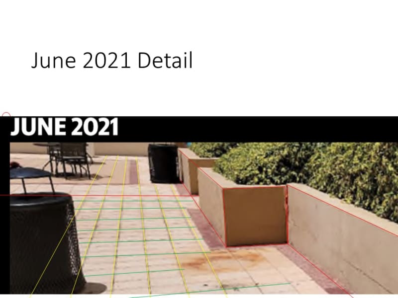

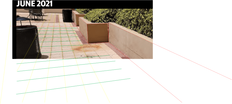

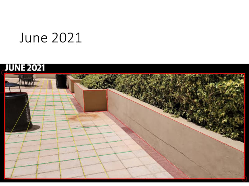

So in the April 2020 photo, I see a pretty radical dip in the pathway coming out from between the two planters, and going left.
In the June 2021, it appears to be much less of a dip.
I am basing this on the helpful color lines overlaid onto the photos.
I wonder why that is.
spsalso
I may have missed it, has anyone suggested the directly that the April 2012 photo may have been taken to document slumping. The building manager has stated that near daily walk-arounds were done for the purpose of property safety. Let's give him a lot of credit for that much. He may have noticed the beginning of movement as early as April. What if we find out there were more photos of the same spot taken even earlier? I mean this is not a tourist photo that was handed to NIST when they requested them.
Edit: belaymylast 2020 not 2012

Reference Fuchsia Arrows on SFC's Power Point Graphic.
As mentioned earlier, would failure at South Wall Under Planters actually cause the 'Catenary Stub Area' to initially move upward, until things let go? Basically the South Wall to Column K15 becomes a bigger lever arm load on the span between K15 and K13.1 for 2 weeks and 2 days?
Edit: Middle Span is 30 feet and much longer than adjacent spans, which begs the question, how in the world do you design a flat slab with same rebar everywhere and same slab thickness when spans are not equal? Looks like it was designed in that 30 foot span would deflect more than adjacent spans, thus providing 40 years worth of unbalanced stress on pool deck? Not to mention the various column sizes and layouts?
On the next two images below, are we seeing evidence of slab drop at South Wall? Note Dark base board like area at wall/patio deck joint?

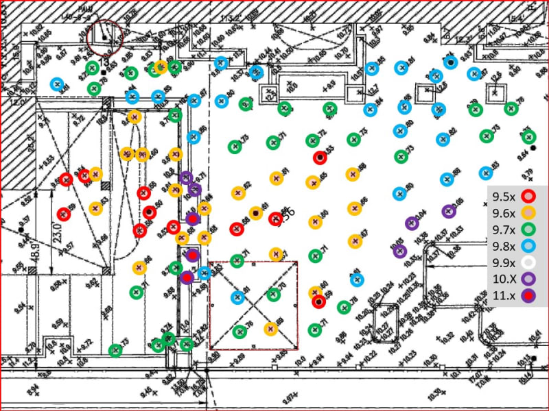

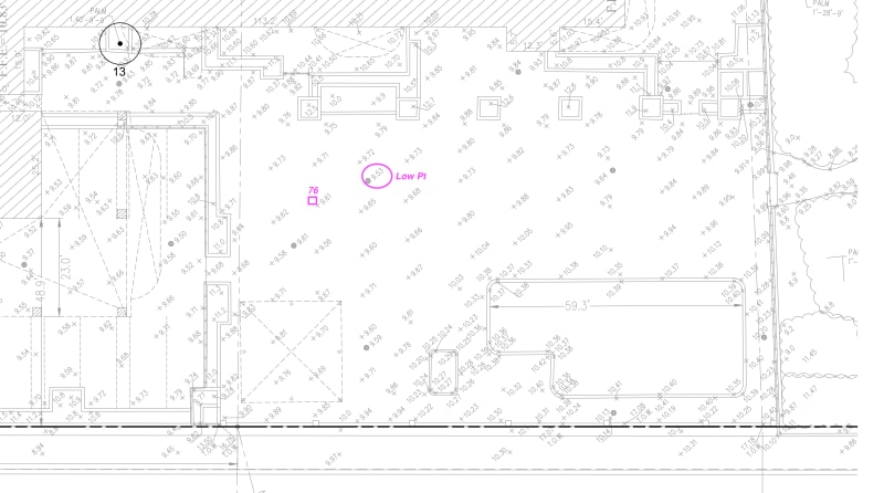

Thanks SFCharlie for those BI links. I watched parts of them again, and this time it sunk in better, I think.....

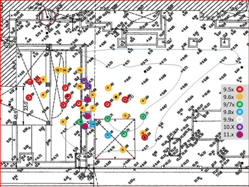

I added where roughly Column 76 is, and lowest point near that column from Survey Posted. This clearly shows why Column 76 was such a good drain path for deck, after perhaps the nearby cracks were epoxy injected.
Edit: Also shows 9.52 low spot on parking deck side of gate from pool deck, with 9.5 drain elevation nearby.
Edit2: I do find it interesting that Building Integrity has NOT linked the Pool Exhaust Fan Exhaust venting East along South Wall, as a probably contributor of accelerated corrosion and slab shear in that area of south wall. I did notice in BI's links provided by SFC, that on one of the original drawings he uses, the exhaust fan originally exited on the West Site of Planter Wall at South Wall, and not East as built.

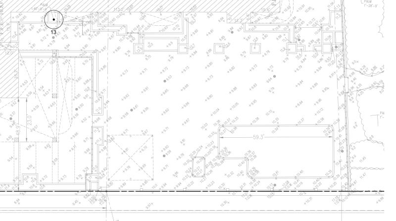

The deck had much less variations in height 8/7/20 than say April 2020 Photo or June 2021 Photo. Per survey only about a 3/10 variation form high to low. Which is pretty good considering the two layers of pavers and sand fill. Problem is Finished Deck heights do NOT necessarily tell the exact story of the structural deck.
It helps me visualize the elevation differences well, much like a contour map would. In some ways it is better to me.
Edit I assume the elevations in the planters is at bottom of planter, which indicates that there may be a layer or concrete forming bottom of planters that is on top of structural slab. Or some sort of elevated base inside the planter, perhaps part of a drain system, or maybe just the dirt level in planters.... Duh!!
If I did not know any different it looks like they were directing water from the entire pool deck to go through the gate and onto the non water proofed parking deck. Then maybe it was supposed to go to the street. I mean assume a drenching rain down pour in which the drains are overwhelmed. Is this the proper way to do it?
