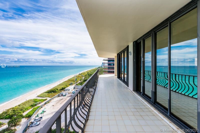

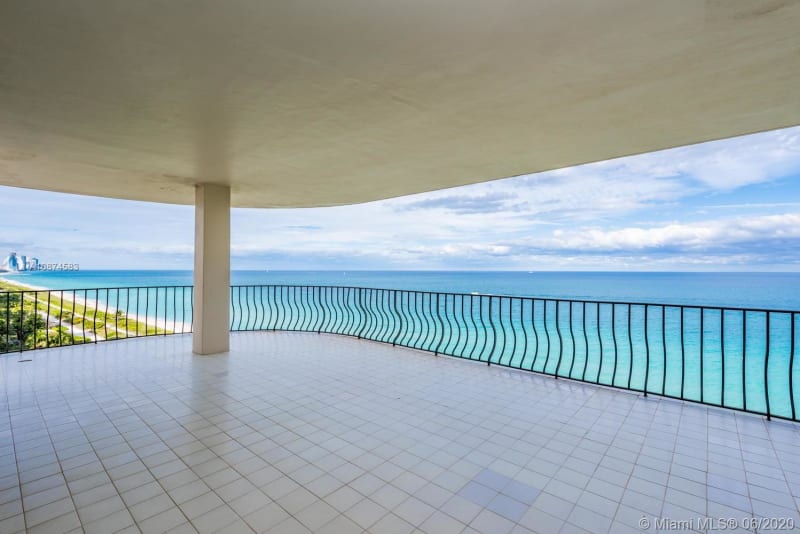

Speaking of roof anchors, could this be a roof anchor attached on the PH-A balcony? I have not a clue as to what else it could possibly be, why it's still there, and what is was doing there in the first place.
Original since potato cam upload.
Not the newest of images. This unit was just sold 05/11/21.
Edit: Core drill for railing with odd rusting stains being blurred and sharpened by cell phone camera? It appears to be protruding up rather than going down in.

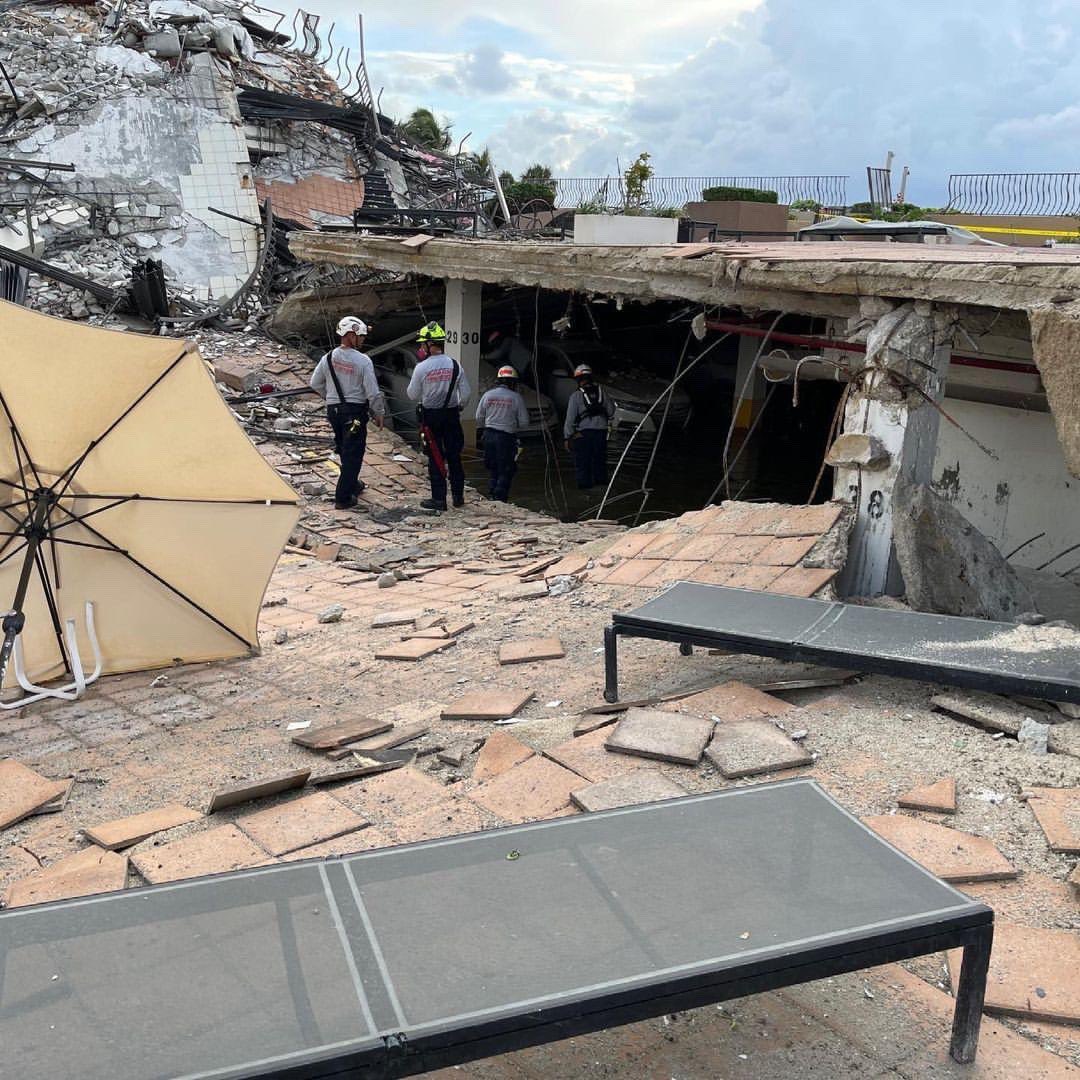

I was about to ask why the hallway sheer walls didn't halt the collapse, and then I realized that, viewing the security cam footage, they did, momentarily. First between the pool side and the street side of the center section and again between the center and the ocean (east) side. I think if this open design continues to be used, a way to limit the collapse needs to be designed. What are the thoughts on how the collapse propagated across the sheer wall central core of the building, and how it could be limited at that core?
