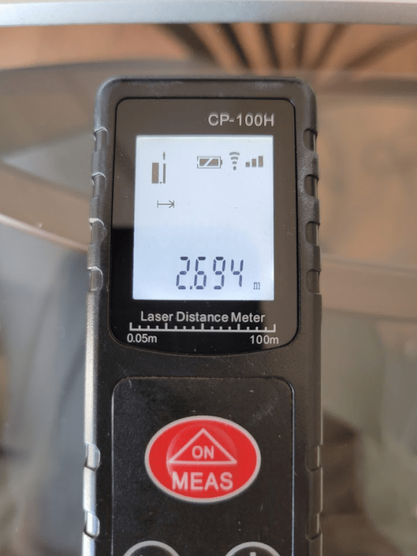

Another option, this laser rangefinder does have 1-mm resolution and pretty decent repeatability, so you can just place it in the same spot and ping the lintel as often as you like.

I'm guessing the concerns with the lasers, etc. is 1) tolerances in consumer laser measuring products (they aren't great...) and 2) variations introduced in setting up and taking down. I think the nails with a thin wire and a suspended weight on one side is going to be the most accurate to get a relatively consistent datum from which to measure.
It's very much #2. Even with a pretty level floor....you'd better set it up at the same spot every time (if we are talking monitoring something like this).
