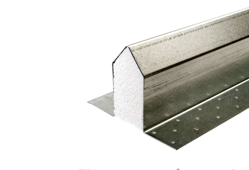

Catnic?
I'm not sure if you have availability of these over in the states, but I would typically specify multiple 'box' lintels
Link
If you then need to pick up the outer leaf of masonry, a beam with a plate to the bottom would work on the outside.
I don't think we have access to those easily.
Didn't say it was a good idea...just an alternative to the I-Beam with a plate.
