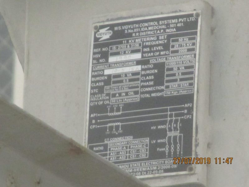

Do you know the reputed 11 KV CTPT metering trafo suppliers in India? For me, accuracy and long-term reliability of the CTPT unit is more important than the initial cost.
For primary side 11 KV metering, what would you recommend, 3 VT, 2 CT or 2 VT, 1 CT combination?
Class 0.2 or class 0.5?
Recommended CT and VT burdens for metering?

Given that trafo no-load current is constant, wouldn't a colder winding with lower resistance have lower copper loss? I don't think the winding resistance plays such a big role in trafo impedance.
I agree that at such a low no-load current, the accuracy of CT (which is 10-5A/5A) and the related MD and PF readings should not be taken at face value unless the trivector meter is designed specifically for it. (I had to develop a very low pf digital power meter specially for testing motors at no-load, whose PF's rarely exceed 0.1. The supplier took instantaneous voltage, current and phase shift at a very high sampling rate to achieve this, thanks to digitization and though it cost me money, the power meter works very well till date). This is one thing I need to check with the new trivector meter supplier. Thanks.

Utility side CTPT unit nameplate.
Given that is 0.5 class, the no-load KVA demand (and no-load PF) is a bit suspect?
