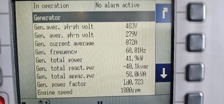

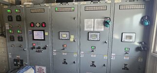

We do have a Voltage spike when we start from a dead bus. we only run 1 generator (117KW, unless the inrush load requires 2, then the secondary unit shuts down after a few minutes. Our power factor is measured both at the generator breakers, measured through our Woodward easy Gen 3000, and at the main bus through our totalizer. Approximately 2 miles of our transmission lines run underground inducing a capacitive load and, in the summer when our inductive loads are highest (Air conditioners, chest freezers, and so on), our PF improves to .78. I have Ignition software for monitoring and trending.
Each generator does have different voltage swings and react differently to sudden loads. 2 units are due for engine overhauls and all 3 generators are due for refurbishing. I have attached pictures of the Easy Gen info, generator data plate and switchgear.
Back to my original question,
How could I calculate an increase in efficiency? Could I correct to a .9 PF if corrected at the Transformer?
Here's what I have so far:
Given this snapshot @ 2.5 gallons/hour and $3.50/gallon, corrected to a 0.8 PF:
((58-(41.9/.8))*.8)/41.9)*2.5*24*365*3.5= $8,311 in fuel savings.
I know my math is off somewhere due to my lack of understanding in the relationships between KW KVA and KVAR, which was the purpose of my original post, and I do apologize for the confusion. I did a different calculation which I believe was correct but lost the sheet (I think my kids drew on it and threw it away). Please help correct my math. If additional info is needed, I probably have it in my trending software.

We have about 2 miles of underground, which I have been told is causing our capacitive load. in the summer, the inductive loads increase our PF to .78
Our current revenue barely breaks even, but I have overhauls I need to do, so I have been trying to "trim the fat". I have only been with the company for 2 years and have been trying to improve the efficiency, but that requires some purchases that we currently are struggling to afford, especially since many of our grants were revoked. we are primarily residential, with only a couple of commercial companies that operate in the summer and the DOT which operates year-round. so far, our operation isn't interested in metering/monitoring KVAR. I am trying to find any improvements that can affect a cost savings in 5 years.
The Ice is still here but melting quickly. The roads have melted, and we expect a toasty summer, maybe even in 90's

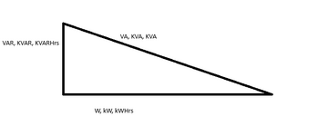

Are you familiar with Pythagoras' Theorem?
W2 + VAR2 = VA2
kW2 + KVAR2 = KVA2
kWHr2 + KVARHr2 = KVAHr2
Power Factor = kW/KVA
41.9 kW, squared = 1755.61
40.1 KVAR squared = 1608.01
Sum = 3363.62 Root = 58 KVA
41.9 kW / 58 KVA = 0.722

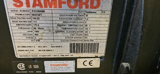

Here’s how I think I would go about calculating losses and seeing if I could get some savings in energy:
Let’s think about the generator only (put a reactor off your switchgear) for simplicity.
This is how I would go about it:
Losses are I^R.
If you get the R off the generator datasheet:
Current is 72A. (From your picture)
Losses are 72^2*Rgen*3=current losses
(the 3 comes from resistance per phase)
Current at 1.0 PF (kva=kw, from the picture looks like you’re generating 41kW)
41kw/(480*sqrt(3))
~50A
50^2*Rgen*3= new losses
Btus/kwh=3412
Btus in a gallon of diesel: 138000
Savings per hour: ((Old losses - new losses)/1000)*3.50*3413/138000.
Assuming .02 ohms per phase (off a 250kw gen datasheet online)
Current losses - 311W
New losses - 150W
Savings- 161 W
I get about $0.01 per hour if I did my math right.
Edit: whoops, I didn’t account for engine thermal efficiency. Assuming the engine is roughly 25% efficient, that BTU/kW becomes 4*3412 =13,648.
So doing my math again that comes to about $0.05 per hour for the generator efficiency improvement, which is about $450 per year. There are a few assumptions in this math that would need to be tweaked for your application.
If you corrected to .9 your current would be:
41/.9=45kVA
45kVA/(480V*sqrt3) = 54A
And the same math as above to calculate losses.
