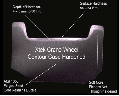

Back to the original query--the max hardness a steel can be hardened to is entirely dependent on carbon content. The max hardness at depth below the surface is dependendent on section size, alloy content and quench media.
Hardness depends on all sorts of things, this marketing picture shows one possibility with AISI1055. "deep case hardened"
