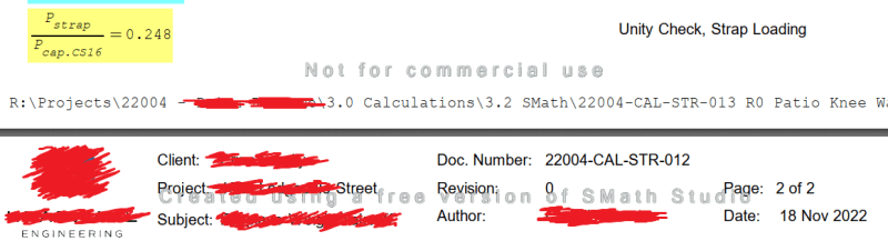

I went to print off a calculation sheet in SMath yesterday, and *Gasp*
Luckily, I was able to download a previous version (1_0_8253) that does not plant this obscene watermark on the files. Sadly, I question whether SMath is going to go down the same route that so many other packages have.

From Andrey:
Andrey said:
I just want to add that this small requirement to activate SMath Studio is a huge step to make this software much more powerful in the nearest future.
You just need to activate the program. It is free.
You can use online or offline activation as you wish.
Once it is done you''ll have no any watermarks or other restrictions.
Why? I will try to explain: I've created a company in Russia and we have a brilliant team of 3 programmers (strong in IT, math, physics). We were able to monetize a project and working hard to make our first clients happy (licensing server, courses, planning and features for companies). We are going to finish our current activities in a Month or two and then will start improve SMath Studio itself: new graphs, stable Writer, performance of the numeric/symbolic calculation engines, new files format (modern and stable) and much more - that is what we will do in 2023.
Hope you'll enjoy the results.
I just asking to activate a program for free! Nothing more...
Best regards, Andrey Ivashov.

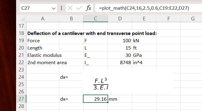

Sure, to set up everything from scratch including learning Python takes a lot of work, but the point is once a custom function has been set up it can be used by anybody just like any other Excel function. For instance, creating a unit aware function just entails entering the function as text on the spreadsheet, setting up a table of parameter symbols, values and units, then entering the UDF to evaluate functions with units.
me said:
The only thing I haven't worked out how to do well yet is display nicely formatted versions of maths text, but I'm working on that.
I have made progress on that. See:
for a spreadsheet that will convert functions entered as plain text to Latex and display on the spreadsheet as an image, and optionally evaluate the function for given input values, taking account of units.
