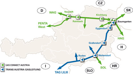

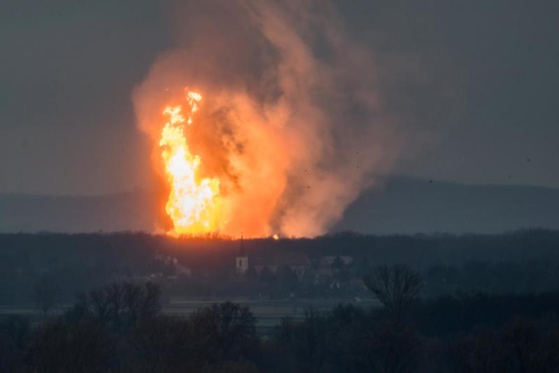

A major fire and explosion at baumgarten in Austria is not good news just as it starts to get really cold in Europe...
This is a major gas connection hub for Austria, Italy and some other locations.

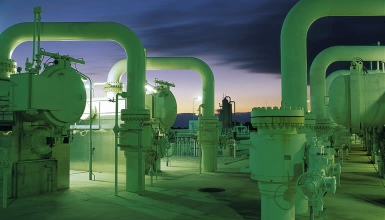

Something like this I guess - this is supposed to be from the plant concerned.
