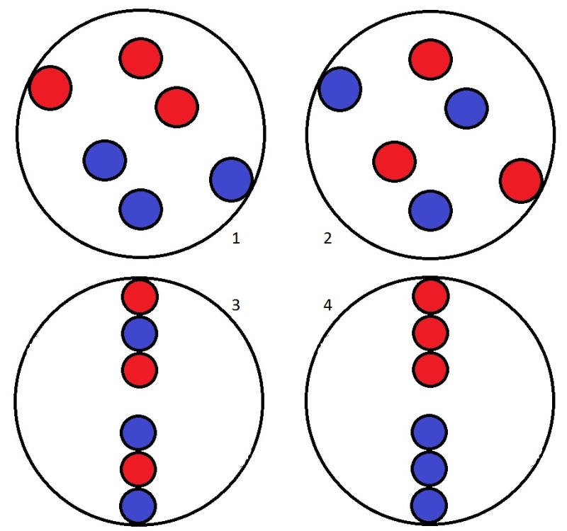

Hi i am a poor [wink] Dutch chemistry student, and i and a other student want to make a couple of magnetic stirrer plate, for home project/study, but the even cost a bout $50 secondhand.
Now i want to make one my self, and have all the parts (about $20 in parts per plate), but only have to decide on the type of Neodymium magnet i should use.
This is the stir bar i gone use.
But i am wondering what the best magnet type would be?
Use 2x round disk type 15x5 and having them facing up and down, and i think having the center of the magnets around the ends of the stir bar.
Or 1x bare type 30x10x5.
And a question, if i would use a longer bar type magnet, could i use longer stir bars later on if i need them, or would 6 disk type magnets work better, paired 30, 45 and 60mm spaced from one and other.
A other question i have about the bar type, am i assuming correct that the poles are on the end of the bars?

Don't use neo, use ferrite magnets. They are a fraction of the cost and will work fine.
You need something non-magnetic and non-electrically conductive for the top plate.
I have seen two types.
One just had a long bar magnet (magnetized length wise) in an Al holder fastened to the motor shaft. The length was just a little longer than the stir bar.
The other style had a set of small button magnets (6 or 8) mounted to an Al plate in alternating polarity. You could make this stronger by adding iron bars between the back side of pairs.
I could make a steal disk, and stick the coin like magnets on to that one.
I i woeld use coin type, hat pattern would be best?
And what material should i then make the disk from? (plastic, aluminum or steel)
For the bar type i would use just a strip of plexi, a little larger, so i can grind i bit of for balancing it.

The simple way is to get ferrite bars, just make sure that they are magnetized length ways.
