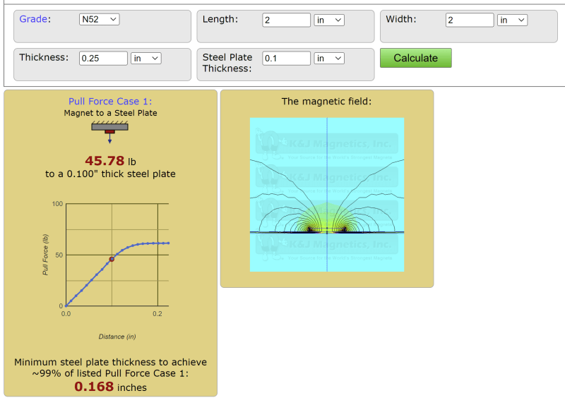

High-level question about magnet arrangements and which might create a stronger adhesion force. I am using an alternating polarity arrangement because I have tested that to be the strongest. The air gap (ground clearance) between the magnet faces and the thick steel wall is 0.4 inches. Also, there is a 0.1-inch thick steel shielding plate that also acts as a yoke. Mathematically, will arrangement 1 or 2 generate the strongest adhesion force at this ground clearance? Thanks for any input!

As far as saturation goes on the shielding plate, I think you are right. The weight of the assembly is a constraint for the project, the low as possible assembly weight with the strongest force from 4 magnets. Of course, the curve for the thickness of plate vs adhesion force would eventually flatten out and an optimal thickness would be achieved.

In #2 you don't need the center, drill it out and make the plate thicker.
So saturation doesn't necessarily care about surface area, it's more related to the thickness of back shielding? If that is true then your point about removing mass in the center and thickening is very smart.
For the thickness of the backplate is there a calculation or anything to find the optimal thickness to do? K&J calculator has a good thickness setting that mentions the optimized thickness. The magnets I use are 1 x 1 x 0.25 inch. So there are 4 of them that's why I assumed a 2 x 2 x 0.25-inch magnet. See the picture. It suggests a 0.168-inch thick plate, but the way my magnets are spread out and alternating polarity has to make this more complex.

But your picture doesn't match your description.
You used a 2.7" sq plate didn't you?
I might try 2.5" sq, hole in the middle, and 3/16" thick plate of mild steel (1010 or lower C).

The Br is 14.4 on the magnet website. The dimensions in the steel plate thickness calculator are for the magnet dimensions, not the steel plate. Since I have 4 magnets (1x1x0.25 each) I combined them to be 1 magnet with dimensions of 2x2x0.25in. I combined them all because the calculator can only do 1 magnet input.
I did use a 2.7" square shielding though. Do you think I should reduce it to 2.5" which will, in turn, bring the magnets closer together? Thanks

The thing about thickness is that if it can't carry the full flux then you are losing holding power.
Your magnets flux comes from a 1 x 1 area.
I would have started at 0.75" and then thinned it until I saw a drop in strength.
If you are milling steel off of the back and the chips are sticking to the back then you are too thin.

it seemed you misunderstood K&J calculator. the calculated plate thickness refers to the steel for your magnets to adhere. The pole piece (for shielding and conducting) is always the thicker the better until to the point any increase in thickness cannot lead to a higher force.
The magnetic flux won't go through the central portion of your pole piece, and so it is literally useless, you can cut off to save some weight.

When you did simulation, did you add the pole piece? the pole pcs can make a big difference. longer distance will increase reluctance but decrease repelling effect (flux cancellation). The pole piece changes fundamentally the flux path. since the cross section area of the pole piece (0.1x1) is much smaller than the magnet (3.14 x .5^2), although the Bd is higher in pole piece than in the magnet (assuming 1.8 vs 0.6kg), the pole piece is probably saturated. you may want to increase pole piece to .15 to .2''.
also, your gap is 0.4, relatively large, and the Pc is low. recommend trying two 1x0.5'' magnets, instead of four 1x.25'' magnets, you may get a higher force.
