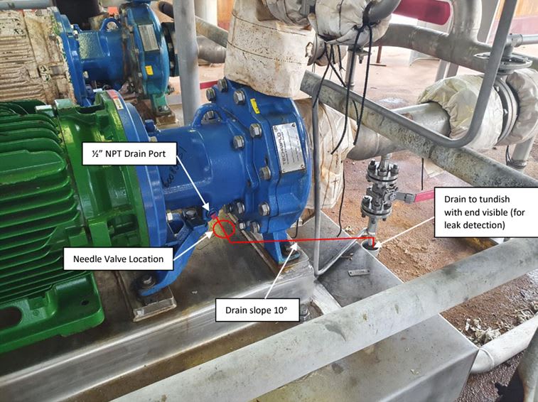

We have experienced weak acid pump failure (again). This pump type is magnetic drive pump (Innomag C4 3x1.5x10) The fluid pumped is nitric acid 40% with temperature of 55 degC and differential head of 1700 kPag. This is the assembly of the pump:
The start up went well however we saw abnormal spike on the electric current of the "A" pump. Shortly after we saw NOx fume and decided to switch to "B" pump & it ran normally up until now. After inspecting the A pump, we found the following pics:
Containment shell worn out due to scratching with magnetic outer drive.

Anyway, our other site in different country also has the same problem with this magnetic drive pump. We use the same spec. They installed a drain to help indicate that a leak started coming, a lagging indicator. But they still do not understand the root cause of the problem.
