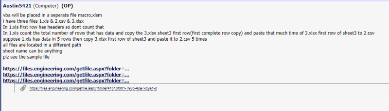

Hey There
Code:
Sub COPYpaste()

End Sub
I am trying to make a macro but i met with a problem so i am looking for help
So plz have a look and help me out

i mentioned the problem
this code is pasting the data incorrectly to 2.csv
Step through your code and identify which line combines all your values to give the wrong output. Use breakpoints and watches to review the values. I can't quite tell as way you've done it looks quite foreign to me. You didn't include your workbooks to enable anyone to run the code as you intended.
Its not the way I would do it, I'd read all the information into arrays, and write/process it to a VBA array with your final layout required. Then write the entire array back onto the sheet in one go. Copying and pasting things like you are doing shouldn't be required (really inefficient).
Sure Bro i have uploaded my sample files and details to u
plz see the pic that i have attached
@IRsruff, sent another eMail that has missing pic. Sorry [blush]
