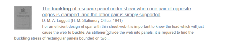

You might try having a look through the Cranfield Aerade:
"The Aerade Reports Archive incorporates more than ten thousand, historically significant, digitised reports from: The Aeronautical Research Council (ARC) - the principal agency in Great Britain with a major output of reports on matters aeronautical, which existed from 1909-1979, and published reports until 1980 and the National Advisory Committee for Aeronautics (NACA) - chartered in 1915 and operational from 1917-1958."
I just searched for "shear buckling of plates" and a bunch of stuff came up. Not sure it will have what you are looking for, but it is a good resource.
Keep em' Flying
//Fight Corrosion!
I went on Cranfield (thx for the link), search for "buckling", sort by published date, 2nd entry ...
is that it ?
