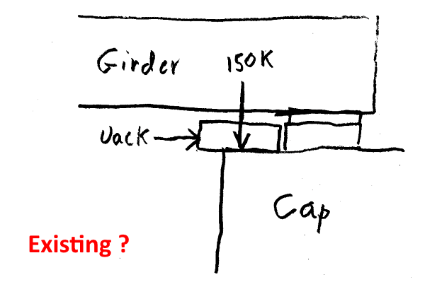

Hello - I’m wondering if anybody knows about any provisions from AASHTO, ACI, or others for dealing with edge loading of concrete? Looking at AASHTO, all I find regarding bearing is in AASHTO 5.7.5 which seems of which seems insufficient for my situation as described below.
The project I'm looking at involves jacking highway bridge girders so their bearing pads can be replaced. Unfortunately, there is only a flat surface of 4” of concrete behind the grider shoes to place the jacks; this is too little as the 100-ton jacks are 6” in diameter. The current idea is to temporarily anchor an HP-section to the side of the pier and weld a PL 2”x16”x16” bearing plate to top. The plate would be positioned so it laps over the 4” of concrete. The jack would then be positioned so it sits over the 4” of concrete and 2” sitting over the HP-section; in the end the center-of-load will be sitting 1” from the bent edge.
I’m concerned about loading such a small area of concrete so close to the edge. The load will be ~150-kips once factored. The HP-section anchorage cannot support much load as the connection is sensitive to concrete breakout, so maximizing the bearing on the concrete is required. Per AASHTO 5.7.5 for bearing, a 4”x16” area of concrete should support ~220-kips minimum, but given how the load is positioned it doesn't feel right taking that as the final answer (the risk of spalling or break-away comes to mind). I appreciate any leads or ideas anyone might have. Thank you.
H.Stone - This sketch is my interpretation of exiting conditions with jack location included:

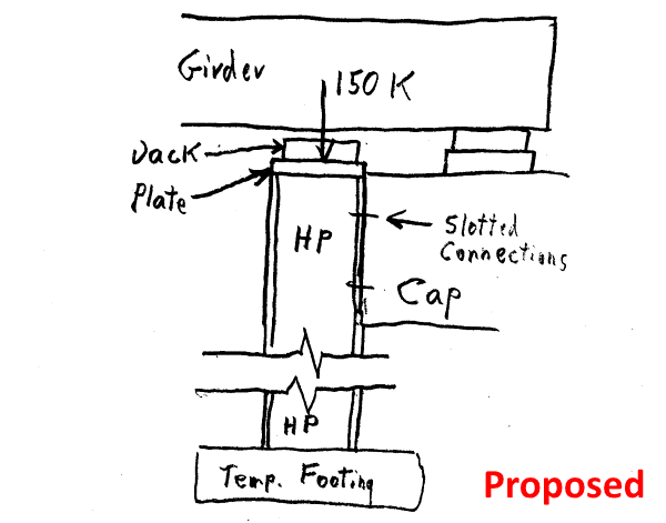

Frankly, I would not use a bracket/plate/cap support for two reasons, even if in the unlikely event there is an obscure specification provision that says this is acceptable:
1) If the bracket "slips", all load is on the 4" lip of the cap.
2) A good portion of the cap's lip, including the centroid for application of the jack's load, is on what I consider unreinforced concrete rebar cover. Whether required or not, I have always applied loads to concrete within limits of the rebar cage.
If practical, I would extend the proposed HP to ground, on a suitable temporary footing, with slotted connections to the cap. Therefore any settlement of the jack/HP/temporary footing under load is not an issue:
[idea]

SlideRuleEra - That's a very accurate sketch of my situation, and a very simple way to solve the problem.
STrctPono - Only need worry about steel girders at the bents this time. I like the idea of sandwiching the pier-cap and keeping everything up-top.
Both solutions are good ideas and I like their respective advantages. I'll investigate both and see which is most feasible. Thank you both for your help and insights. Keeping bearing loads within the reinforced section makes good sense the more I think about it.

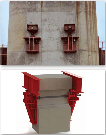

[idea]
Think how shoring companies like EFCO and Dayton Superior do it when they are pouring pier/bent caps. It doesn't have to be such an elaborate structural section like these but the concept is the same.

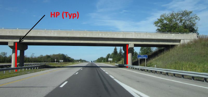

I guess the big question then is what is your access like?
If it's over water or has really tall piers... posting down won't work.
If it's a typical grade separation bridge, then posting down probably wins out in cost.
