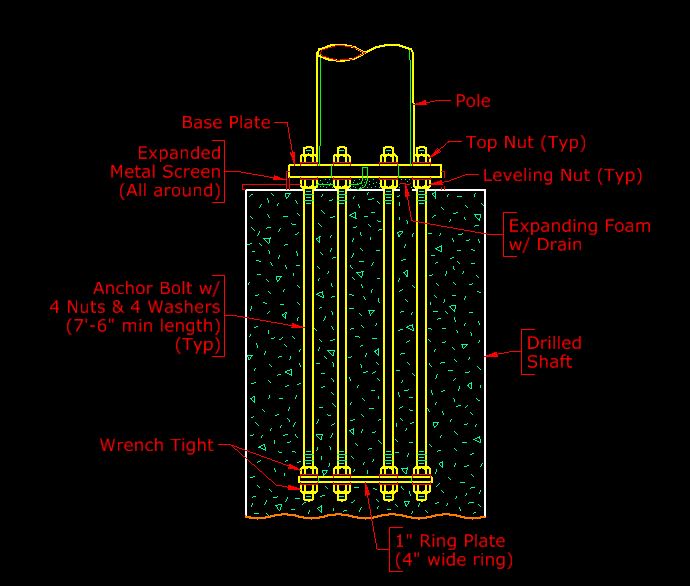

FYI, not sure what your specifications or codes say for the spacing of the reinforcing bars, but the AASHTO LRFD spec requires a minimum clear spacing between bars in CIP drilled shafts of 5 times the maximum diameter of the aggregate in the concrete, both horizontally and vertically, in recognition of the inability to vibrate the concrete deep into the shaft. We use a special concrete mix with 1" max aggregate to reduce the clear distance required to 5", so we can use a 6" pitch for the spirals.
I would avoid the plate with the double nuts on the bottom. It introduces a plane of weakness at that level.
The plate at the bottom of the anchor bolts is typically a ring plate that is only a few inches wide. It's the standard configuration for the anchorage of a large pole base.

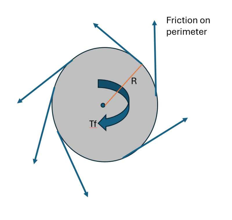

You mentioned Torsion is usually not an issue. But unfortunately, we are struggling with providing torsional resistance !! Please see below if the calculation makes sense.
1. Factored torsion demand Tf = 1.3 (wind load factor) x 921 = 1197 kN.m [Refer to load table in my first post]
2. This demand is resisted by soil friction over the perimeter of the cylinder multiplied by radius (R) multiplied by length (depth). Looks like we need about 16.0 m of depth to resist the torsion !
Tr = [3.14 x 1.6 m] x [1.6 / 2 m] x [2 m depth x 0 kPa + 3 m depth x 12 kPa + 11.0 m depth x 25 kPa] = 1250 kN.m > Tf [OK].
Here Skin Friction values in kPa are as shown in the Geotech Table in my first post.
So, the cylinder depth is 11 + 3 + 2 = 16 m !
Is this reasonable? Is such depth common for cylindrical foundation for large signs on highways?

Thank you for pointing out the bottom plate. Its purpose is to hold the anchors in place. It's not very thick.

But, as Bridge noted as a narrow strip, maybe a couple of inches wide.
dik said:
Have you looked at the added capacity of the 'ring plate' compared to actual heavy hex head anchors?
Well, we need something to keep the anchor bolts straight, anyway, and with the ring plate we can count on full development of the bolts at that level, and the allowance for transferring the force to the reinforcing outside the ring is reduced (we assume a 45 degree angle for the force angle from the outside edge of the plate to the longitudinal reinforcing bars. Without the plate, we'd have to add several inches to the bolt length to ensure the tension on the bolts gets transferred to the rebar below the development length for the bars. They're already 7'-6" long by 1 3/4", Grade 105 rods.

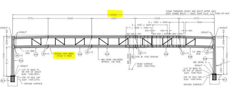

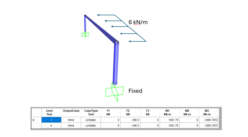

Let's look at a practical example. We have this large 55.5 m overhead sign. Post height is 9.5 m (average). The ULS factored wind pressure = 2.9 kPa, acting on design sign area. This is equivalent to a 6 kN/m UDL on the horizontal beam.
The analysis shows that there is about 1066 kN.m torsion at the base. The foundation needs to resist this torsion.
Globally, the summation of torsion is zero. But at individual foundation, there is that torsion to be resisted.
Perhaps I am missing something ?!?!
If the bases of the posts are considered fixed, there will be torsion at the base.
Well, I guess they could be considered partially fixed, but soil doesn't provide rigid fixity against rotation. You'd have to take into account the movement needed for mobilization of the soil resistance at the interface with the shaft, and check how much resistance is mobilized at the maximum rotation of the columns allowed by the bending of the horizontal chords.
That rotation is limited by the chords. The horizontal chords should be designed to resist the lateral bending moments due to wind load internally. In other words, the design of the sign structure should not be relying rigid torsional restraint, nor any torsional restraint at all, from the foundations. The rotational movement of the shaft needed to mobilize the torsional restraint would be very likely be associated with an unacceptably large lateral bending deflection of the horizontal chords.
For design of a sign structure such as the one you posted, we would assume the foundations are free to rotate, and design the horizontal chords for the moments produced by the wind. So, the horizontal chords would be simply supported for wind load at the columns.
I also seriously doubt that the connection between the chords and the column could transfer that magnitude of moment.
