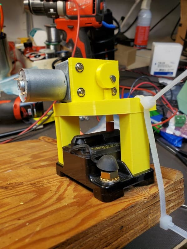

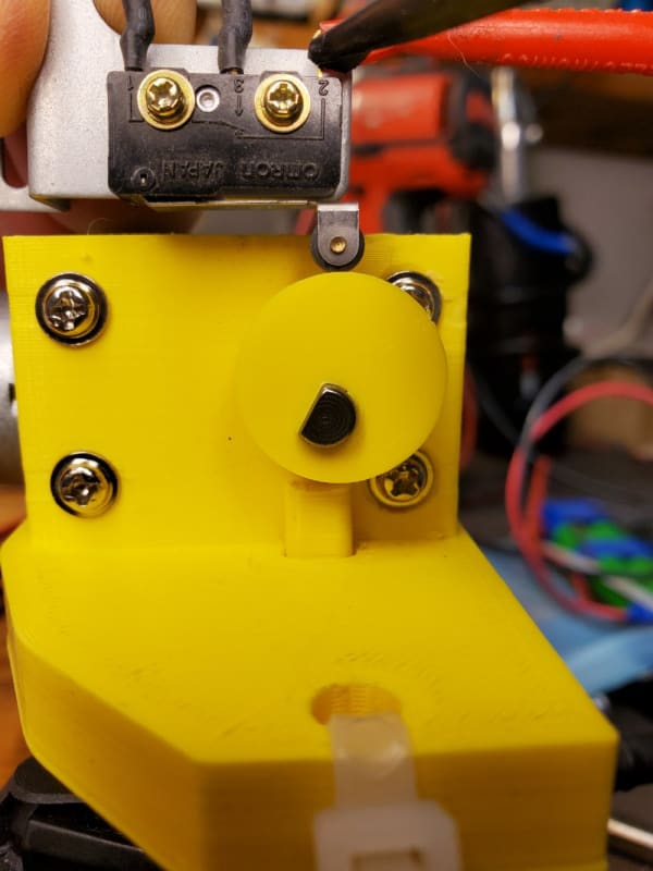

Yes! That is what I need. I need it to self stop once it's cycled. To cause a cycle I short the "stopping" microswitch at the top of the cycle.

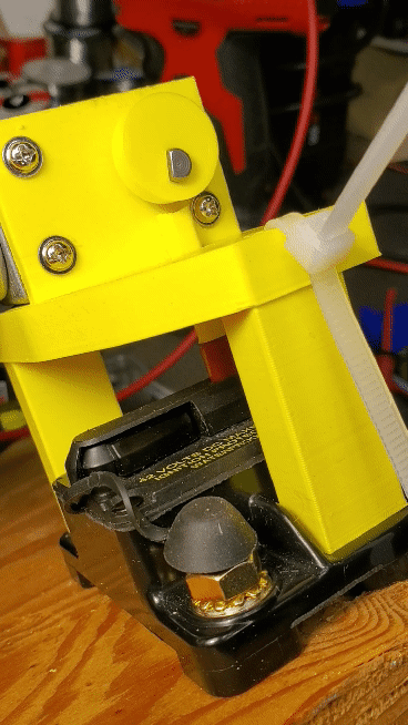

Here's what I've come up with. Note the quality fastener tiewrap. That's what you get when you discover you need 2-3/4" long fasteners at 2AM. The other side is a toggle bolt. Gross!
TADA!
Note: The whole point is to poke the manual trip button on the circuit breaker. Done enough you see the breaker arm swing out.
Next I'll rev it so it has this on it to terminate each cycle.
Total cost per unit with zero standby current $19. Not counting the, -ahem- cost of BricsCad platinum and its near vertical learning curve.

Observe the point contact on the pushrod and the offcenter forces.
Consider a convex end rather than a concave end to minimize point contact.
Move the pushrod to or slightly past the center of rotation to minimize side forces.
Or reverse the direction of rotation of the cam.
Or, considering that this may accumulate a dozen operating cycles over its lifetime, and that many only if you get a bad batch of batteries;
Ignore this post and use it as is.

Wouldn't using a convex contact point increase the point load forces causing accelerated wear? I thought maximizing the surface contact would reduce wear, but what do I know being a sparky.
I've probably run that thing about 30 cycles already and can't actually see any degradation.
I also think I see a tiny side shift of the 'rod' against the red button.
But your point about a low cycle life is probably a good one unless I attempt to use a battery with a really weak cell that causes daily ejection from the herd. Probably won't do that though I do in fact have a battery with a low capacity cell. A $^@%*!# 185 lb battery with a bad cell.

In your case it is not very important, but the concave is changing the motion profile so that the cam alone is not controlling the motion any longer. A flat top on the cam follower will result in line contact, and allow slight rotation of the follower to get even wear.
Hi Keith. Take a close look at your video clip.
You have sharp point contact for almost all of the stroke from the edge of the concave.
You have some full contact at the bottom of the stroke and then some sharp point contact on the upstroke.
The flat surface suggested by Compositepro may be better than the convex that I suggested.
That will give point contact from a curved surface rather than a sharp edge.
That said, that is some nice programing to print that concave end.

Interesting stuff Il'l confess I'm having difficulty wrapping my head around. That is the 'point loading' aspects of the various head shapes discussed. Wish I had a graph of position verses pressure or something.
At any rate the red button force goes up linearly with distance being probably 3x harder to push at the bottom. I am pleased to see the most contact surface occurring at the bottom of the press. However I'm surprised to see pretty much only point contact everywhere but at that one point. I was expecting there to be a large contact surface everywhere not at only the bottom.
The cad package allows one surface to shear off another one. Though, that was indeed a painful bit of learning.

What you appear to be missing is that the cam eccentricity results in a side-to-side movement as well as up/down. Your follower cannot follow the side-to-side movement, so your cam does not stay seated in the concave that you made.
This may work with a previous suggestion that I proposed.
Gang those devices together and use one gear-motor and multiple cams.
Cut your pushrods 1/4" short and use small solenoids to insert spacers so that only the units with the solenoid energized trip the switch.
The feasibility of this approach depends on the relative price of solenoids vs the price of gear motors.
