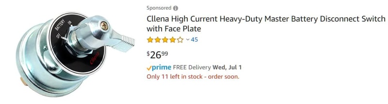

While OFF and ON would be nice I can live with OFF only. This means a solenoid type action where a PLC generates a brief ON could maybe pull something. Perhaps something like one of these kill switches.
Or perhaps twist something like one of these:
Or pulls open one of these:

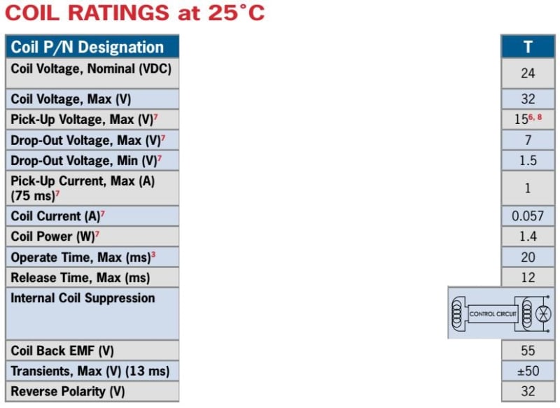

Heck, the GIGAVAC one I'm using requires the DC current thru the main contacts flows in a particular direction or the lifetime is cut to 1/3 the cycles.
Good point David. My PLC doesn't offer -outputs really.
Steve that Hersee is a nice one. Still $1,500. Groan.
Bill; the three I just bought have it built in - part of the "control circuit". The energy penalty for 10 would be 1.4 x 24 x 10 = 336WH per day. Way better than most others that land in the kWH per day realm. For the GIGAVAC T model; $0.10 on grid or 1/2 a solar panel off-grid. The losses across the main contacts are frequently hideous. Except for these GIGAVACs I've seen 10's of watts in some cases. They'd be smoking hot, all wasted energy.

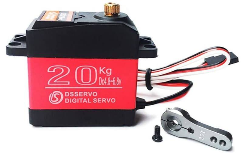

I really liked the idea of using one of these:
And a small chain to one of these:
20KGF is probably way more than needed so I could buy a ten pack of 1KGF servos for ??$30?
The chain connection would allow one to walk up and turn off a battery regardless of the PLC not turning it off. Then manually turning it back on all without digital intervention.

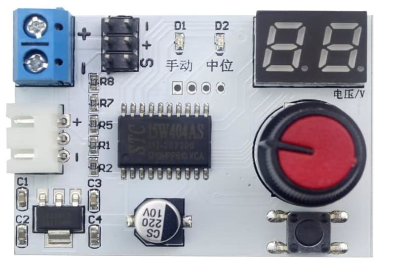

But! Servos require that 2ms pulse train to keep them in position. That required adding something like this "servo tester":
That servo test board that has position memory (the pot). I'd then need the PLC to power-ON the servo test board that would wake up and drive the servo that would pull the chain disconnecting the battery.
Started seeming pretty cumbersome. Then you read some negative (gets hot!) reviews on the switch and you start wondering if you're building your house on a low tide sand bar.
