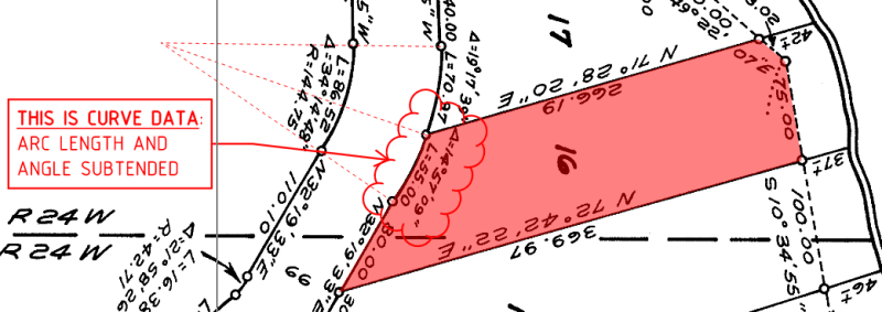

1503-44 Thank you for your reply. Part of my problem while I worked on surveying during the summers when I was in college, I did not prepare plat maps or work with them. I also need to learn more about GIS maps and programs.
When I started my project I thought I could set up a transit on one of my property pins sight down to another pin. Then turn an angle to establish a new bearing. After measuring the property line distance I thought I would end up at the approximate location of the pin I am looking for.
However now that I am looking closely at my plat map I can see that to use it I have to convert some of the information. At one of the property corners the map gives an angle of 14 degrees. However on the map the angle is over 90 degrees. From reading my old survey book I think that is an angle off the north south section line. I also don't know how to interpret the information given along one of the property lines. The distance between the pins is 266.19' the other information is N 71 degrees 28" 20" E. I have tried to attach a copy of my plat map but I don't know if it worked correctly.
I need to find a surveyor who has recently done some work in the area where my cabin is. I know there is one owner on the lake who brought a new piece of property on the lake and had it surveyed about three years ago. I need to find out who he used.
Actually my problem involving the jointly owned property may be easier to solve than I thought. Looking at the plat map it looks like the pin I need to locate is on a section line and about 750' from a section corner
Thanks again for your help.
 https://files.engineering.com/getfile.aspx?folder=43e1f5be-aef8-4aa5-9638-5e54a1add48c&file=Plat_Map.pdf

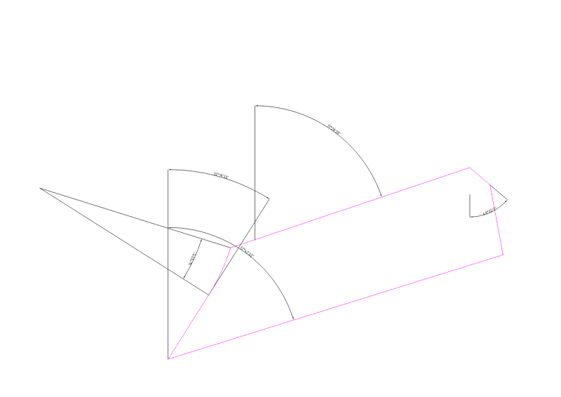

RARWOOD:
Based up the length data you provided, you are talking about lot #16.
If I am correct, then the 14° you refer is Δ, the subtended angle for the arc segment along WILDERNESS WAY. Interestingly, it does not give you the arc radius, R, but the opposite side of the WAY does, so you can calculate the radius on your property line (+ 66.00 feet to make a R of 210.75'). The L of 55.00 is the arc lengh of the curved boundary.
The N 71° 28" 20" E is simply the bearing quadrant, with NORTH running RIGHT to LEFT on the plat survey.
Knowing the line of N 71° 28" 20" E (with distance 266.19') then you should be able to use a theodolite/transit or a total station to field locate the other boundary points.
I input it into AUTOCAD and all the bearing quadrants and distance, arc lengths etc all check out...as they should.
Thank you again for your help. I am glad you mentioned AUTOCAD. I have Turbocad and it never occurred to me that i could make use of it to help me solve my problem.
Locating the property pins for my lot 16 is not a major issue. My know pins are the two outside corner pins at the lake end of the lot. At some point in time I want to add a shed. To maintain the correct property line set back I will need to know the approximate location of the property line.
Regarding the joint owned property I need to get an estimate from a surveyor on the cost of locating the pin. I have checked on renting a total station. As I told the person at the rental place it is a question of cost. When I get an estimate from a surveyor I can compare it to the rental cost of a total station.
Than you all again. I am learning a lot and see that I would benefit from reading more about creating plat maps.

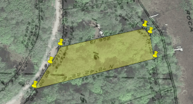

Here is the pdf map overlayed onto Google Earth
I have numbered the principal points, 1 through 6
These are the APPROXIMATE longitude and latitudes of those points
POINT COORDINATES DEGREES AND DECIMAL DEGREES
LONGITUDE (-WEST), LATITUDE (+NORTH)
<name>1</name><coordinates>-93.38075667029992,46.62712840995998</coordinates>
<name>2</name><coordinates>-93.38081037214721,46.62733521659605</coordinates>
<name>3</name><coordinates>-93.38087606402392,46.62738899410758</coordinates>
<name>4</name><coordinates>-93.38184130733794,46.62718779073304</coordinates>
<name>5</name><coordinates>-93.38194479531761,46.62704345547674</coordinates>
<name>6</name><coordinates>-93.38210021622741,46.62685394987196</coordinates>
If you turn on the Google Maps App in your phone and watch the latitude and longitude as you walk around there, you may be able to find all the pins. Google Maps have some inaccuracies at times, so I can't tell you how far away from each dot you might actually find the pins, but they should be within a couple-three meters. If there are pins there, I think you will probably be able to find them.
I have attached the kml file of the overlay and point placemarks. Open that file with Google Earth and you can see it too.

thank you very much. The information you provided will definitely help me find the pins or at least get close.
This weekend I was up at the lake and tried out my GNSS Land Meter. I started at points 1 & 3 because their are pins at those two locations.
At point 1 I got a reading of 93.3808,46.6271
At point 3 I got a reading of 93.3816,46.6271
In the area of point 4 I got a reading of 93.3807,46.6271
At one time there was a wood stake in the area of around point 4.
When I took my reading I was just guessing on where the stake use to be.
I won't be able to go up again until after the 15th. However the next time I go up I can stay longer and will take a metal detector with me.
