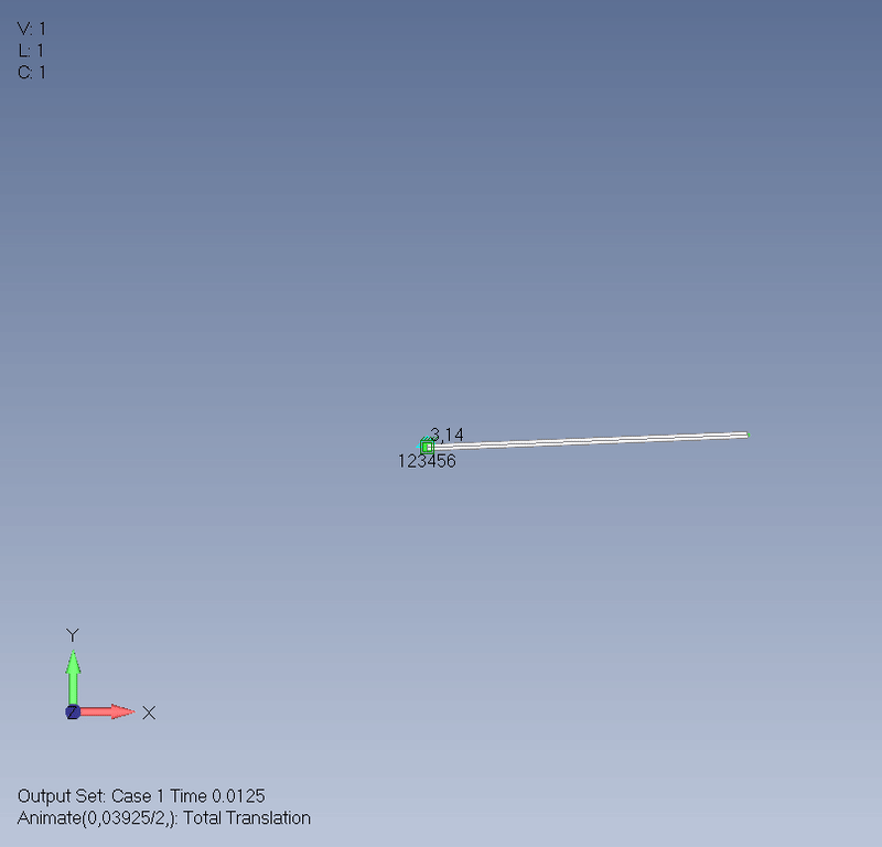

Hi
i can make move x,y,z direction in rectangular cordinate system. But how to make 1/4 circle move? I try change cordinate system to cylindrical/spherical but it works like in recatangular.
x^2+y^2 = R^2,
x = R*cos(theta),
Y = R*sin(theta),
0<theta<pi/4
Thanks for your answer :)
i have done like that:
1. I made two function: vs. time function with sin(360*!x) and with cos(360*!x).
2. I made two load -> displacement, first x direction (time/freq dependence function with sin()), second y direction
(time/freq dependence function with cos())
3. I have to use sol 601 becaue "vs. time function" don't want work with other solution :(.
4. it works :).
There is my another question: is any other simple method? Why i can't use angle move in cylindrival cordinate system. Some time ago I symulated "Spherical roller bearings" with spherical cordinate system and then it work excelent - but there it was constraint.
My observation: spherical and cylindrical dordinate system works only with constaints. It doesn't work with loads.
Print screen on attachments.
 https://files.engineering.com/getfile.aspx?folder=b12e1a7d-1ac7-4cd0-a2be-bcb459c6839c&file=eng_tips.png
Why do not use Enforced Rotation?
Hi
You can probably do this in both a non-linear transient solution and a non-linear static solution.
But I assume there is a purpose with this that goes beyond the 1/4 circle move. What is it that you want to simulate?
