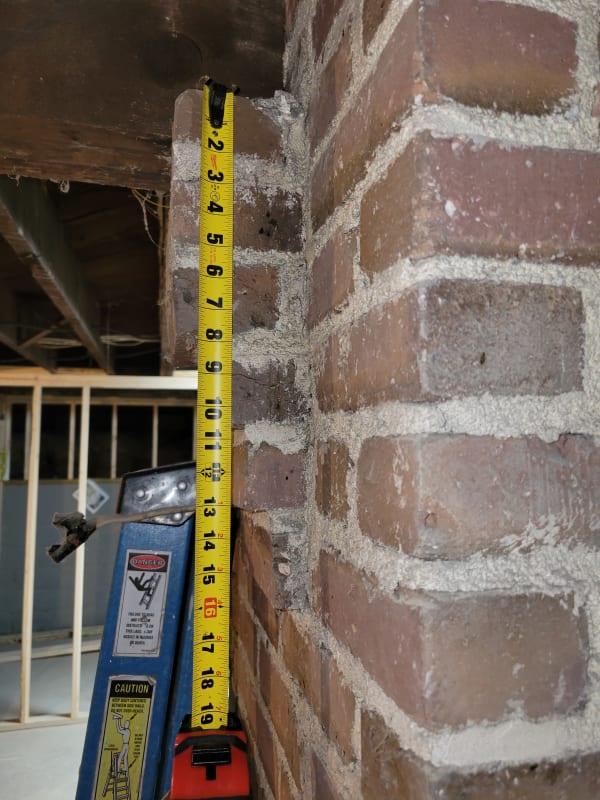

I have a client that is wanting to remove the center beam support in the now finished basement. I have sized the replacement beam and looked at the new end bearing loads which are roughly 3x what they were. The existing bearing pressure is 150 psi and the new conditions push that upwards to 375 psi. From what references I have been able to find, the corbel is constructed as it should be. Are there any references on calculating the load carrying capacity of a corbel?

Here are 2 pictures of the corbel.
I am planning on requiring additional support in the form of shear bolts or an additional column but I was curious if there was a load calculation somewhere.
The current loading conditions are coming up with ~2.8k lbs (live and dead loads) with the modified condition being closer to 10k.
The strength of corbel is not the only issue to be resolved. You have a load of 10,000# acting at an eccentricity of at least 6" from the center of the wall (I am assuming it is a double wythe with a total thickness of 8"). It is probably more like a 7" eccentricity because the beam rotates and bears more heavily on the inside face of the corbel. The moment applied to the top of wall is approximately 70,000 inch-lbs which creates significant tensile stress in the wall, possibly an unrealistic expectation for hundred year old brick and mortar.
The foundation is likely a non-reinforced strip footing of unknown width, and we have no idea what bearing pressure the soil can sustain. If you are expecting the wall to act as a deep beam to spread the load over a larger length of footing, the wall would be subjected to bending stress.

You write "bearing pressure" so I assume you are not meaning shear stress. With 10,000 lbs it looks like you'll have over 200 psi shear on the corbel (in best case scenario) so I'd def add something to carry that load. I'd think some sort of cleat or steel bracket underneath the existing corbel would be the approach I'd start with (sounds like you might be thinking that also). Whether you put one steel element underneath the corbel or two on the sides with an angle or bearing plate under the new beam might depend on how mane anchors you need to support the load. I'd look at getting all of the load into whatever bracket you add due to possible difference in stiffnesses between the corbel and the steel bracket attachment.
If they could stand to lose a little floorspace, you could just add a column and footing next to the existing chimney (as close as possible). That might keep things pretty simple.
BA, the masonry component is a chimney and not a wall so.... eccentricity MIGHT not be such a big deal since I expect the chimney has lots of dead load. The 10,000 probably involves a lot of live load which does not often materialize in a single family residential situation. Still it's something to check on...
I may lose business with my approach to this, but I'd be telling the owner that we're using a new column and footing for this end of the new beam. You can probably put it 12-18" from the chimney and not deal with whether the existing brick can carry triple the load.
Often in a situation like this all the information you need to properly calculate the capacity of this corbel is unknown. f'm of the brick? type of mortar? footing under the chimney? capacity of the soil? In my experience: unknown unknown unknown unknown. You can make a good guess at these things, of course, but I take into consideration the type of failure that would occur if I'm wrong.
I'm with you kipfoot, this isn't even something I would bother trying to analyze. Too much risk vs reward on this one.

Regarding this specific corbel, based on the Australian Masonry standard AS3700, it would appear to fail.
Ultimate load is 10,000 which is 45 kN
You would need a shear area of 45000/0.72MPa = 62500 mm2 to satisfy just the shearing force through the vertical plane. You appear to have less area than that crossing the shear plane (mortar doesn't count, only bricks crossing the plane).
You also have some moment on the corbel, which adds tension to the bricks, making things worse.
