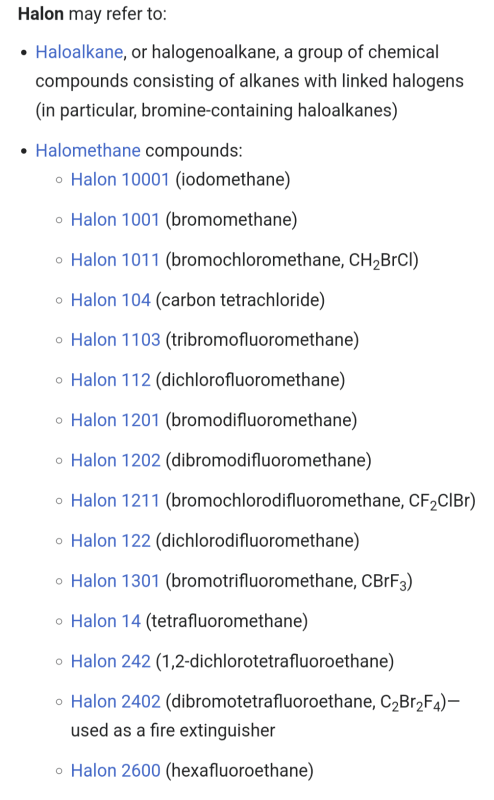

Which Halon product are you referring to?
Halon 1301 is by far the the most common. Halon 1301 works at low enough concentrations that it should not be hazardous to life.
