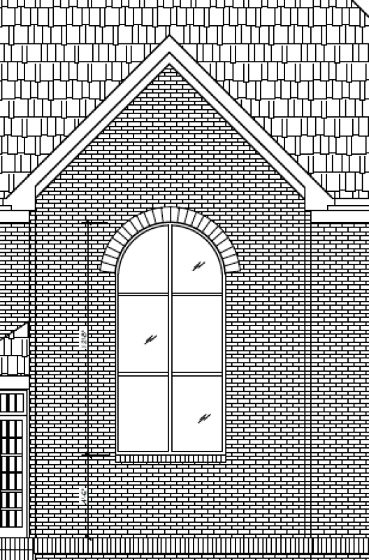

The builder does not want to use a lintel. I wouldn't either. The window is 6 ft. wide with 4 ft. of wing wall on each side. How do you all feel about a few courses of joint reinforcement over the arch and call it a day?
