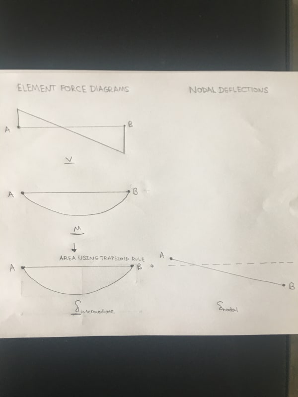

I have recently become very interested in matrix structural analysis and finite element analysis and I have been creating my own "program" using excel. Of course I have quickly noticed that the basic operations available within excel without using VBA is somewhat limited and I cannot make the quality of the program I want. So naturally I have began learning VBA and in my journey around the internet learning VBA I have seen other recommendations for more powerful languages such as Python, Matlab, Fortran etc..

My apologies IDS, I asked about the method used to find deflection on your beam program, but I meant to ask about the Frame4 file, since I’m building a general frame program now. For now I have been trying to use the double integration method by creating sample points at every 0.25” of beam length and obtaining values for shear and then calculating the approximate area under the curve with the trapezoid rule to find moments, slopes, and deflections, I figure I can always tighten up the distances and make the result more accurate, since I can’t think of a way to get an exact equation to integrate. (So this is the simple beam portion of your example above)
The last thing I am still trying to figure out is how to deal with end conditions on my deflection values, which I think you gave me the answer to above, but I just haven’t quite grasped the concept. I of course already have nodal deflections calculated for purposes of finding element forces, but I have to figure out how to make the intermediate deflection results and nodal deflection results “agree”. I’m just not quite grasping the idea of making a system of equations, because I’m not working it through equations, but a set of approximated points. Of course equations would be better if I could figure out how to create them :)

You can create the Shear, Moment, slope/rotation, and Deflection equations for each load type using direct integration, doing it this way you can greatly reduce the number of stations to just what you need for a smooth plot and avoid the compounding error of approximate integration routines (I found this to be about 20 to 25 stations along the span).
Once you have these, or you can take them from my github here: Link, then at each station you can calculate the desired result per load type and add them together, superposition, to form the total response.
To account for end deflections you can again use superposition and either do linear interpolation between the two nodal deflections or form the line equation and get a direct result.

Ah I think I get it! There are intermediate deflections caused mainly by the internal moments along the beam span, which can be found by integrating the moment (I chose the trapezoid rule to do this previously) and there are nodal deflections found from the stiffness matrix solution. A unique beam deflection can be found by each case at discrete stations and then combined to form a final deflected shape. The only thing I haven’t taken into account with this explanation (I think) is the effect of moment constraints, which will hold slope=0 at the boundary and should be reflected in the deflected shape. My first thought to show this is by putting an if statement in the first 2 stations of the Intermediate deflected shape that basically says if the node is fixed against rotation the first two stations deflection should be 0 (maybe I would have to adjust how many stations to add this condition to based on how it made the plot look)

Celt83 I was hoping I got back to the post before anyone else did. I was doing something else and it popped into my head how silly I was with my struggles on how to include the deflection from a fixed end. Of course the reaction moments at fixed end will result in another shear-moment diagram that can be integrated to find the deflection and then superimposed. Your picture makes it even clearer and I can’t wait to add intermediate deflections to my program.

I still recommend not doing numerical integration via trapezoidal or Simpson rule and instead come up with the actual slope and deflection formulas for end moments or more generally for a moment applied at any point on the beam.
Formulation of those slope and deflection formulas are actually the foundation for the stiffness matrix that your using so would be a good exercise anyway. The bending stiffness entries in the matrix come from solving the simultaneous equations for introducing unit slopes and deflections to either end of the beam.

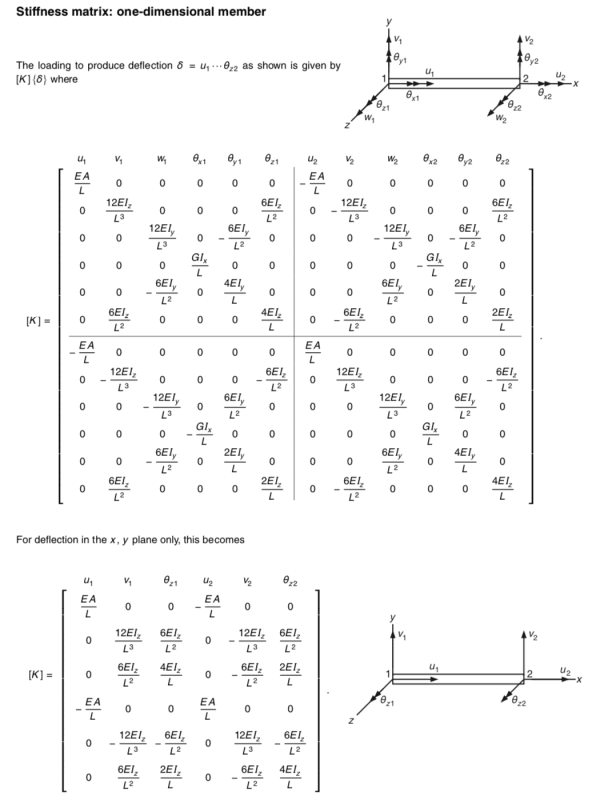

@OP,
For a beam element FEA solver you have to work with generic formulas for beam deflections under generic loads. This is a complex topic, however I reckon I can give you the generic stiffness matrix:
Generally speaking you have to do the following:
1. Discretise your load.
2. Discretise your beam.
3. Generate a load vector and assemble a corresponding corresponding stiffness matrix.
4. Solve the resulting matrix equation for the displacement vector.
5. Post-process and derive moment/shear/displacement diagrams.​
You certainly need to discretise a bit further than 4 sub-elements to get accurate solutions - ideally you make number of sub-elements an input into your function and then you can vary that number to see how number of sub-elements affects accuracy of your solution.
You really don't need to sub divide the bar elements. If you have the general formulas worked out all you need is the end moments and you can then construct the full piecewise formulas for shear, moment, slope, and deflection and solve for the roots to find locations of absolute maxima and minima. With the piecwise formulas worked out you can then just take a sampling of stations along the bar so when you plot the diagrams they look nice enough, you can speed up the backend a bit by doing the station values on demand when showing the plots vs preprocessing them and having them stored in memory. When you plot inject additional plot points just before and after load points this gets the discontinuity in the shear/moment diagram shown with a nearly vertical line vs diagonal line with uniform spacing of your reporting points, also inject the root points.
Sub division would be import if you are planning on performing a natural frequency, transient and non-linear analysis. Even if you are applying loading based on piece-wise functions, you can attain a solution using Laplace transforms coupled coupled with a coarse stiffness matrix...
