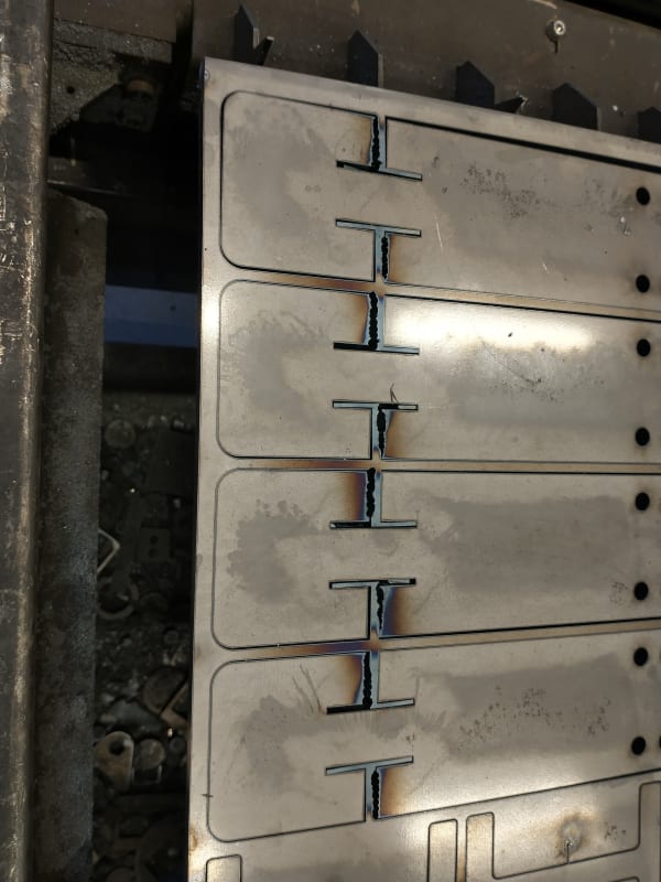

Hi everyone.

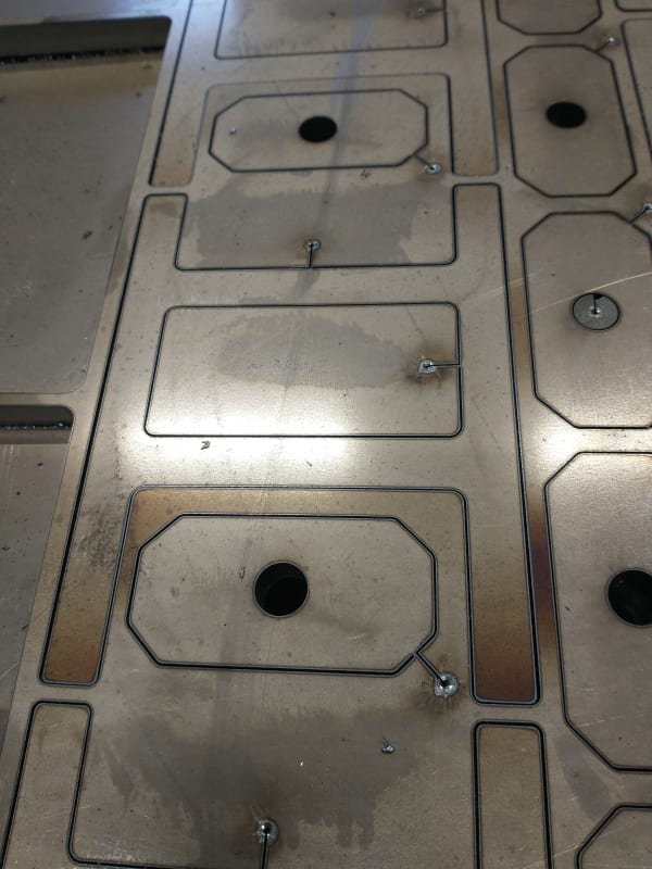

I have this problem with thicker sheets 10-20mm sometime it is better and i have no idea what the problem is?
somethimes it doing the same in holes and after corners too. Can someone give me a clue what to do about it?
post your cut condition and photo of edge so we can see whats happening. looks like low speed and focus too high above plate could also be an o2 pressure problem
I have found that on older machines, it helps to have all assist gas pressure settings the exact same.
Set your pierce, edge approach,and cut gas pressure all to the same value. Personally, I prefer 0.05MPa.
Also, I have better luck with the 2.5mm double nozzle than the 4.0mm double.

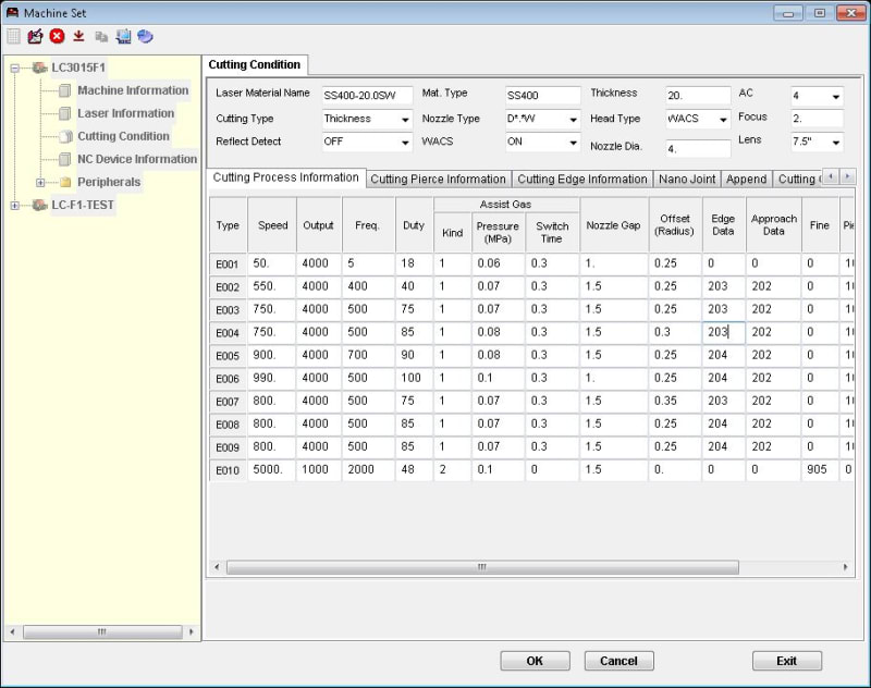

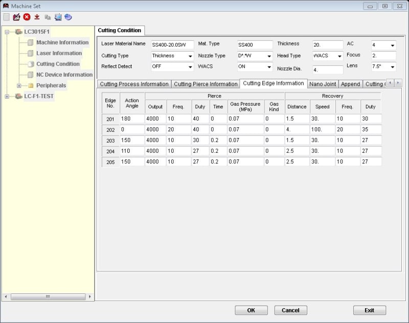

This is the cutting condition for the 20mm sheet that I hade picture of. I use E003 for holes and E004 for contours.
from what i see gas pressure is too high nozzle diameter is too big and focus is too high.
gas should be 0.05
nozzle diameter should be 2 or 2.5
focus should be top of plate currently you are at 3.5 mm above plate (this is why your kerf is so large.
and possibly nozzle alignment needs correction.
Thanks for the respond.
I have to lower the gas pressure and se whats happening. I have not tried another nozzle then 4mm Wacs for 15-20mm thickness, 10 and 12 with 1.4mm Double nozzle. I have tested to tune the focus but that has not helped for this problem.
I tested 0,05 gas pressure today with 15mm sheet but it did not work at all, left plenty of dross under the part.So back to 0,07 for now.
parts with rounded corners did good.
But some was a disaster.....

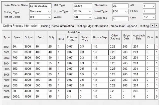

Still problems with 20mm sheet. Can someone show an working cutting condition list for 20mm with or without wacks please so I can compare to my own settings.

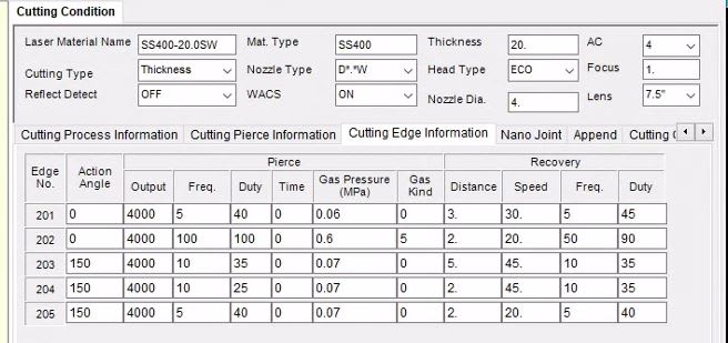

these values worked for me.
but they where tuned for a resonator that was in need of cleaning.
changed all mirrors and haven't tested how these cut after that.
my theory was that going slower with lower power and duty helped the resonator keep cutting.
also a dirty or old bad focus lens might be the issue to cuts like that.
Tank you, I will test your settings and see if they work for me. It is so many settings and we didn't have any training because it was an used machine.
