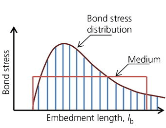

I see your point, thanks for making it. I think that the situation is made more complex by the fact that:
a) bond stress is not expected to be uniform along the length of the lap.
b) development / lap performance is often limited by slip behavior.
