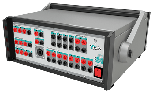

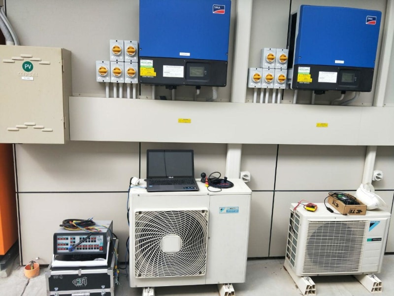

Dear Ben
I have a friend from Melbourne with a new secondary injection set brand, named VEBKO Amt105 unit[reading], it's compared to Omicron CMC356 [flip] with hight accuracy to my ponovo PW336i, with much pretty price. He uses the device, usually in his PV Project, mainly to verify power metering, directional, differential protection, and calibrated in Trescal Group Australia, they are very familiar with all protective devices and experts in measurement and and calibration..hope my advice take a consideration from your side, and save your money[thumbsup2], also you can go with the SVERKER 900, very practical but useful in analog injection as well only[pc3].
Hope this helps, Nelly
