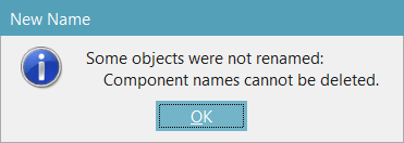

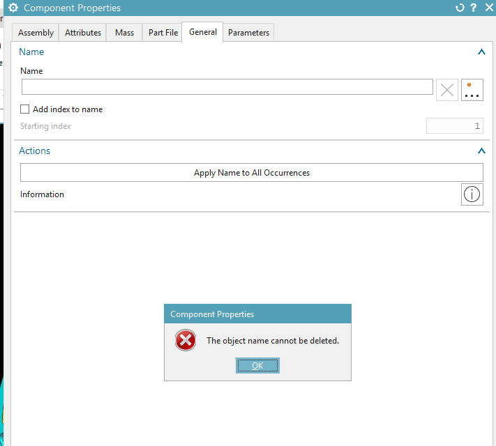

Thanks for the feedback, when I try to delete the name, I get a message saying The Object Name Cannot be deleted. There is an X beside this field but it seems like it does nothing and greyed out. It mentions in the tool tip that it will delete names. We are running 1899 version 1919 revision. Or how ever that numbering revision version is now working. We are also running under teamcenter.
I have the 1911 version installed for testing (not connected to TC). When I try to delete the component name, I get the same message. I think this is just telling us that the component name cannot be blank; when you press OK on the message, the component name will revert to the component file name. The previous custom name will be cleared (but the name will not be empty), and if you do a save-as on the component file, the component name will update to the new file name.
I'm currently downloading the 1919 version for testing.
www.nxjournaling.com
Thanks my system never reverts, it goes back to the old name that I had in the assembly. It seems like it is stuck with that name until we rename manually here. Once again appreciate your feedback.
