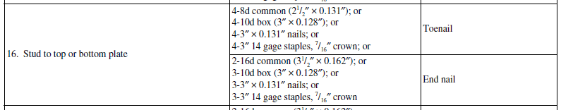

Per 2019 CBC Table 2304.10.1:
If you need more capacity, I recommend a clip (Simpson A34).
SE2607, the OP's situation is for a floor joist to sill plate connection.
The relevant entry from the 2018 IBC Table 2304.10.1 is item "21. Joist to sill, top plate, or girder"
3-8d common toenail
3-10d box toenail
3-3"x0.131" toenail
Right, I'm familiar with the IRC nailing schedule, but the question is how many toe nails is too many?
