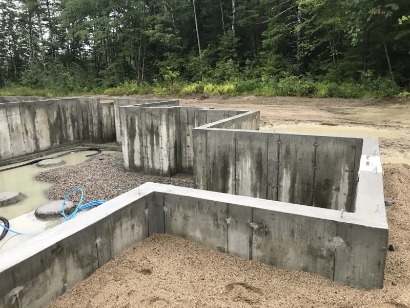

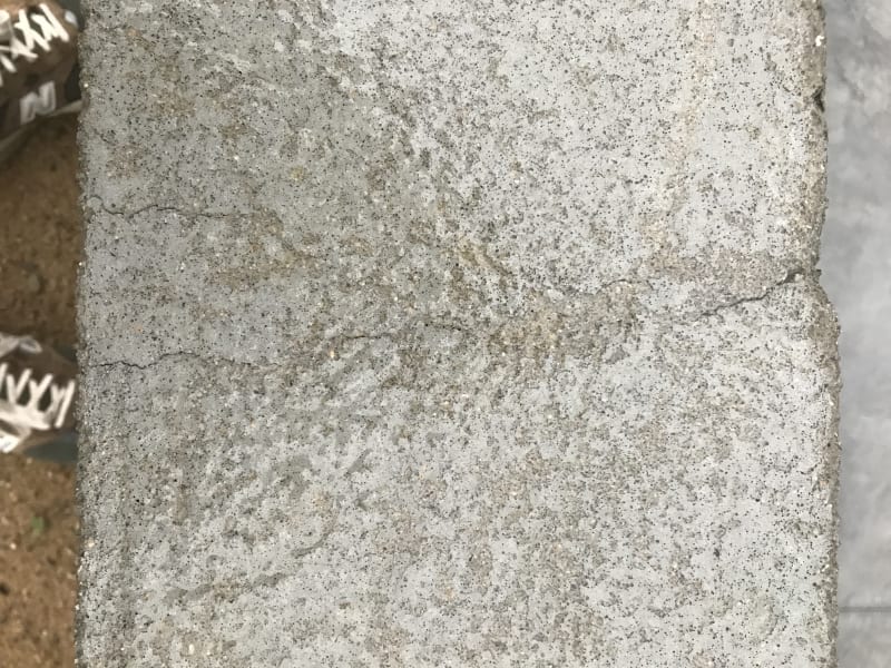

shrinkage cracks but basement wall cracks in general. It seems to me that, when real issues crop up, they tend to be associated with things like frost and hydro-static pressure rather than -- or perhaps in addition to -- shrinkage cracking. Some additional comments regarding my experience with cracked basement walls.
1) When I practiced in WI, cracked basement walls were a thing. Almost a cliche really. If I'd cared to, I could have easily made a living out of just driving around looking at people's cracked basement walls.
2) In Alberta, where I currently practice, cracked basement walls are just as much of a thing as they were in WI.
3) On this forum, I have seen many, many examples of cracked basement walls all over the US and Canada in both concrete an masonry.
4) Do all, or even most, lightly reinforced basement walls crack up? Of course not. If they did, practices would change. In this context, I think that a "high risk for cracking problems" probably means something on the order of 5% of the homes that get built this way. But, then, that's still too much in my opinion and the opinion of that lucky, one in twenty home owner who has his or her basement go to hell in a hand-basket.
