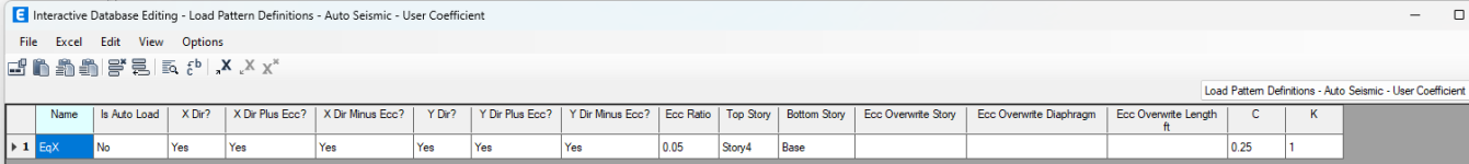

Good morning everyone,
I am trying to take advantage of the Interactive Data Base Editing using ETABS and whenever I change something mostly in the load patterns and try and run the model, it gives a miRunAnalysis error and also it will not let me save and if I go to define load patterns the program crashes, when i try to save it says error cleaning load patterns arrays error cleaning seismic arrays. What im i doing wrong the interactive database is a powerful feature but why cant i run and save my model after i edit my load patterns? It works the first time around fine but not the second time around.

Thank you for your reply, I am editing the load patterns table, specifically a user defined auto seismic load pattern definitions - auto seismic - user coefficient table. At first when you edit and run the model it will be fine, but any more subsequent edits cause a "miRunAnalysis Error #9" unable to clean load patten and seismic load arrays. Then the program crashes.

What version of ETABs are you running? I tried on v22..0.0 and was able to reproduce the error.
Image of the functional load case.
Before:
After:
Error:
I would submit a ticket on this to CSI.
