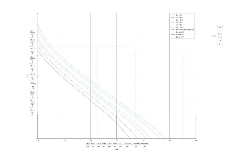

So I decided that I no longer wanted to be beholden to Woodworks etc and I would make my own stud wall MathCAD sheet. Go me. I wanted it done differently than what I see most folks do though. I wanted to generate interaction diagrams so that, for given project, I could just generate the diagrams for the handful of wall types that I'll use and then pick values from the graphs as needed. The graphs below do this I think. Each line is a different duration factor (0.9,1,1.25,1.6). They are for 2x4 stud grade 92.625" long; wind (psf) on the x-axis and axial (plf) on the y-ais. I've attached a printout of the entire worksheet for the ambitious.
I've spot checked some results and they seem to be okay. What's bothering me is how straight these curves are. The only action is at the top left in the first diagram where things get curvy with low levels of wind pressure. If you include minimum axial eccentricity of d/6 like software often does, even that goes away. That's what's shown in the second graph below.
So my question is this: does anybody have enough experience with wood stud wall interaction diagrams that they could confirm or deny if the results I'm getting look nuts. Considering how straight the lines are, I would have thought that NDS would just simplify the equations to suit. Frankly, if it's this linear, I feel pretty silly for even going to the trouble of making this spreadsheet.

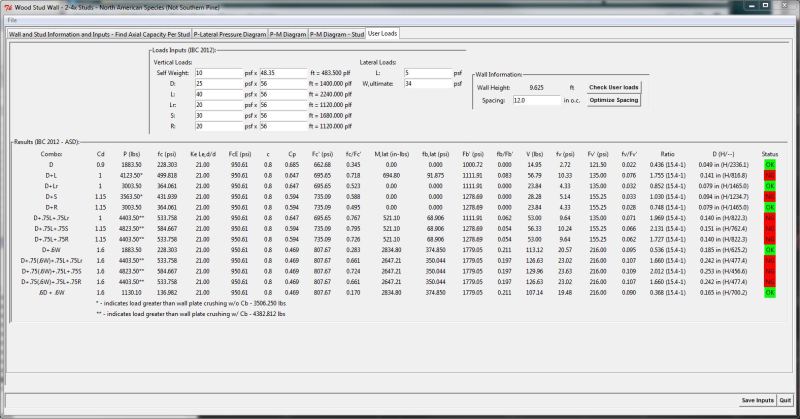

correction:
-User Loads - Self Weight was being considered as an eccentric load when eccentricity was considered, it is rational to assume that self weight would apply concentric to the wall panel and not eccentric.
enhancement:
-User Loads - Spacing Optimization - first pass check of 24" o.c. will now occur before the routine enters its loop. 24" is the upper bound for Cr=1.15 to still apply.

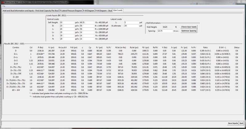

I have a program that is too old to print so I screenshot the outputs directly into a PDF. Not sure if Windows does this as I do most of my work on a Mac.
Dik:
No worries wasn't taking what you were saying as criticism. The output side of things is something I keep reading up on, right now you could right click on any of those files and print to your or any PDF printer it'll just be plain text. The hard part, as far as I know, is that "formatted" word for anything beyond new lines and spaces things get a bit tricky.

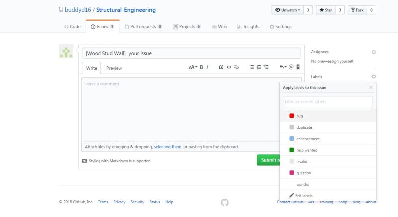

I kind of have this to a point that I'm ok with it and not seeing anything that immediately jumps out and bugs me. If anybody finds anything they'd like added/corrected please let me know. Easiest method would be to file an issue on github to make it a little easier to track please put [Wood Stud Wall] in the issue title. If you could also give it label that would be helpful too in prioritizing calculation corrections over feature requests.
