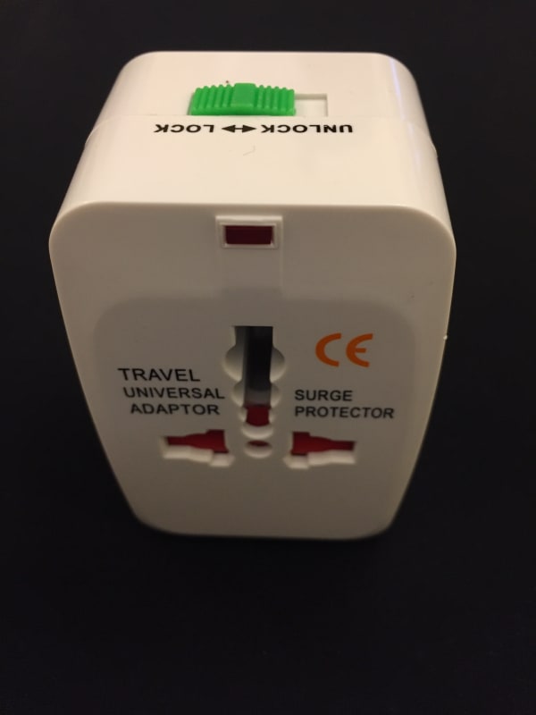

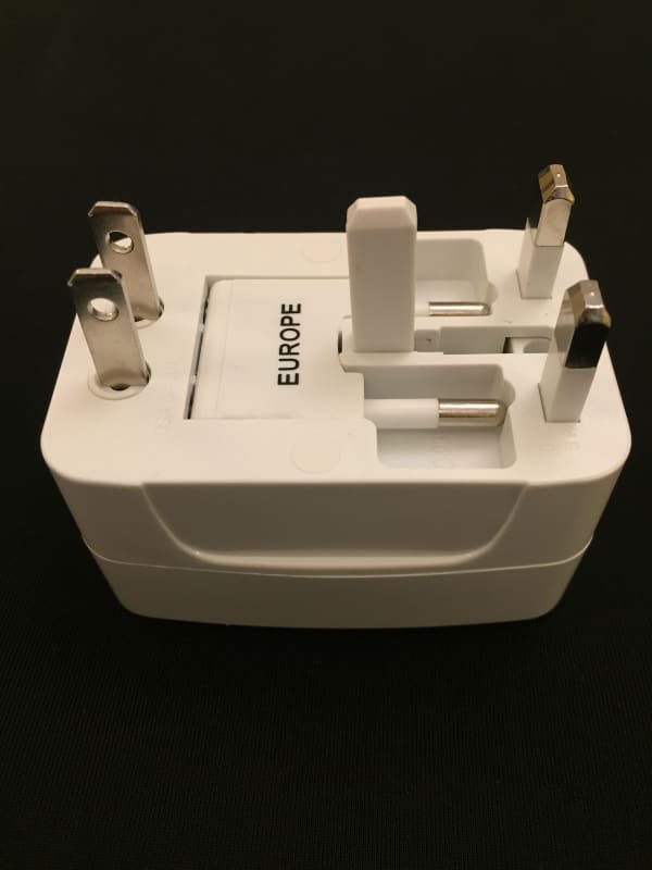

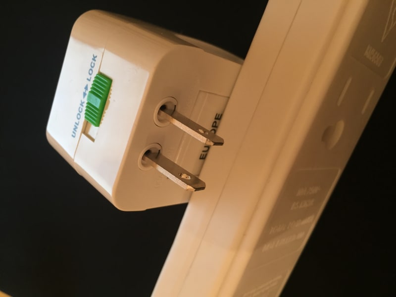

That reminds me a bit of this product my father bought a few years ago. After he complained he'd "had a bit of a buzz off it" I confiscated it and complained to Trading Standards.
An international adaptor where it was possible to deploy more than one of the alternative sets of pins simultaneously
...leaving a shocking amount of live metalwork exposed when you plugged it into a power bar.
Turns out the Hungarians had issued an EU-wide ban a year or two previously, but individual retailers were sourcing stuff direct from China without realising that in doing so, they were taking on the Importer's responsibilities under EU product safety directives.
A.
