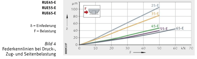

In my Ansys workbench project i have a pads with a known stiffness and i wish to use a spring connection insted of the classic bond connection.
Do you have any reference in order to do this?
I think i have to select the 2 surfaces and then add the stiffness i need in [n/µm] or similar

I wish to add this stiffness between a pad and the body it carries
